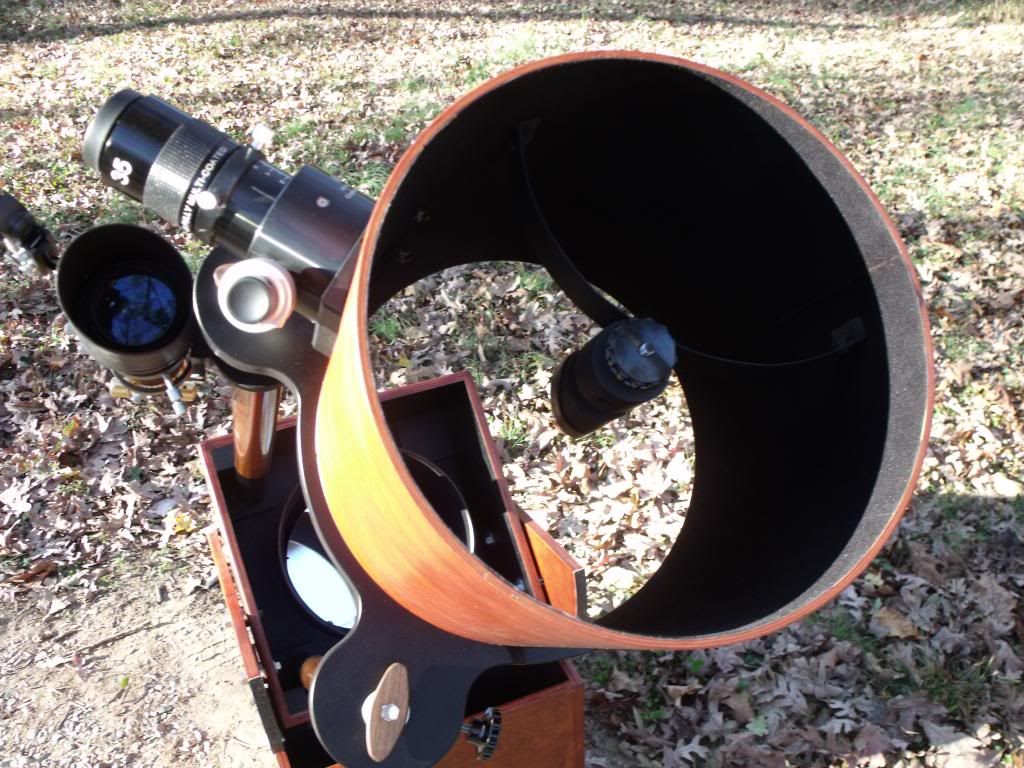

Now that Ive been using my new build, it does not hold collimation horizon/zenith as well as I'd initially thought. A thorough testing revealed that the dual struts and UTA are rock-solid, no shifting. The problem is the curved spider. It sags as the scope is raised/lowered.
I wish to keep the curved spider design. Should I remake it with wider metal? I used a steel ruler for this first one, which you can see in the pic below:

To my eyes the spider support is almost entirely invisible in the posted images, and what can be seen is indistinct. Can you post another?

Re: My curved spider sags...suggestions? new [Re: careysub]
      #5530284 - 11/20/12 02:18 PM
Ill try, having a devil of a time with the pics today..
http://i104.photobucket.com/albums/m194/tcmzodiac/SKYSPYUSEFIRST-1.jpg

      #5530288 - 11/20/12 02:20 PM
Notice that on my spider, the mass of that 1.83 secondary is fairly distant from where the vanes attach. Wondering if that imbalance is the prob and...if so...if I could balance it via washers at the opposite end...or am I just plain dumb????

      #5530350 - 11/20/12 02:48 PM
Sure enough, there is but one screw per side per bracket; but they are cyano glued as well. Ill be checking this but...the laser pattern moves up/down repeatably. The flex just has to be in the vane it seems...the ends are fixed pretty well. The vane is .055 thick.
The "node" end is bolted/glued to the mounting bracket...the bracket is affixed to the UTA via one bolt.
