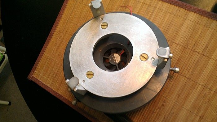

Here is a view of a 6-inch cell under construction. It is almost identical to the cells used on the "Woodshop" telescopes from S&T, March 99. Single small fan, centered on the rear of the mirror.
A rear view. The aluminum cover on the left is the battery compartment. 8 AAA cells provide either a high or low speed, provided by the DPDT, center-off switch seen at upper right.
This cell design has been in-use since 1998 and works very well in a closed-tube. I've used it on 6" f/8, 6" f/5, and will be using this one on a 6" f/10.
The six-inch cell fan clears-up image degradation within 2 seconds of turning on the fan, even with very warm optics that have been sitting in a closed, hot garage all day.

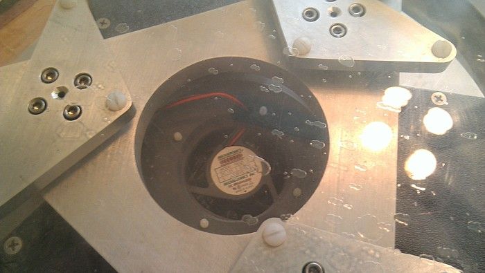

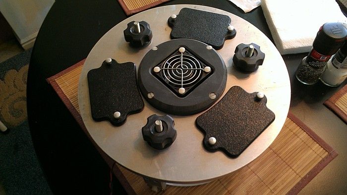

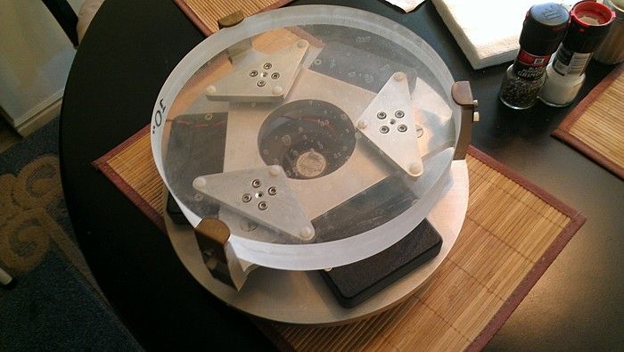

Here is the same concept in a 10-inch, 9- point floatation cell. A dummy plastic disk is sitting-in for the mirror in these pics. The three black plastic housings each hold 8 AAA cells.
The back side of the cell. This one is also designed for a closed tube. Here you can see the access doors for the 3 battery compartments as well as the collimation knobs. The fan itself is mounted in a PVC block on a Sorbothane gasket. The PVC block is also separated from the aluminum back plate by another Sorbothane gasket.

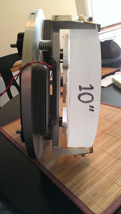

A side view of the cell. Each collimation bolt has 2 springs, one inside the other. The batteries will be wired in parallel to extend the run time of the fan. I'll probably use NiMH rechargeables and be able to charge them from the car 12V system enroute to the observing site, or at home with a wall wart type charger.
You can also see the stainless-steel ball-bearing pivot under one of the floatation pads. Each ball is loosely caged by the 4 SS allen-head screws that also hold the pads themselves. The balls nest in conical seats on both the back of the pads, and the cell back.
Looking through the plastic dummy mirror at the "out" side of the fan. While this system works very well in the smaller 6" scopes, I haven't tried it yet on the 10" (12" OD aluminum tube), so I have a plan for a second fan blowing across the face of the mirror if this arrangement proves too anemic.
