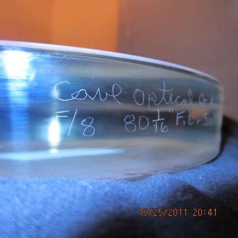

An example of the cursive style engraving on my 10” f/6 Custom Super Deluxe:

An example of the block style engraving on my 8” f/8 Model B Deluxe. This one was made shortly after the ‘roll over’ from 9999 to 0001:

Jon, thank you for taking time to do this. You can add mine to the mix. S/n M762404, Dec 29th, 1976 Cave 10" F/6 Model C Custom Deluxe. Block letters.
Compressorguy
Reged: 03/14/09
Loc: Clayton, NC
Re: Cave Mirror Registry new [Re: Compressorguy]
      #4413282 - 02/26/11 03:59 PM Attachment (71 downloads)
Block letter style inscription.

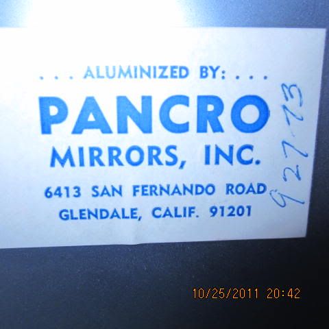

      #4413307 - 02/26/11 04:16 PM Attachment (89 downloads)
I love the look of the older mirrors. The way they left the glass "clear" and with the radius edge. I find it unusual the way my mirror is finished. Mine has a frosted edge and bottom finish and the top edge has a distinct 1/8" bevel cut. Wonder when this practice started? Was it from a different supplier?

Very cool idea! You can add my 8-inch Cave refigured mirror to the list if you like. The serial no. is R 1589. The engraving is on the back of my mirror, not the edge. Is that unusual? See picture attached...

      #4415900 - 02/27/11 09:04 PM Attachment (67 downloads)
I'm in.
cursive writing.
#749223
F/8 47 1/8" F.L May 7 1974
1975 6" Student Deluxe.
Current (2nd) owner Neil Barnett

      #4415963 - 02/27/11 09:36 PM Attachment (52 downloads)
Here is my mirror picture.
PiSigma

      #4415968 - 02/27/11 09:38 PM Attachment (39 downloads)
Here is the serial number.

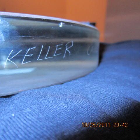

      #4415993 - 02/27/11 09:52 PM Attachment (36 downloads)
Wow what a day, a caveman award and a winning car, congrats. I am the current owner of the mirror you list being owned by Greg Stone. Included is a photo for additional info. Not visible in the photo the year is 1977.
Great idea and thanks for committing the time to do it. Very interesting information on these excellent scopes. Present owner of this 8" light weight deluxe- Gerald Elkin

      #4491825 - 04/02/11 04:31 PM Attachment (27 downloads)
Thanks Steve.
I wonder what the "MF" prefix means?
Is the engraving in cursive script or block letters?
Do you sill have your 6" RFT? I don't have a picture of that one and am wondering what style the engraving is on that one too.
Hi Jon,
Sorry for the delayed response....work gets in the way of fun The attached is a picture of the serial number portion of my 6 inch f/4 Cave (Block letters).
Steve

      #4491928 - 04/02/11 05:42 PM Attachment (26 downloads)
Thanks Steve.
Jon,
Apparently the "F" was a figment of my imagination...pictures are better!!! Attaching three pictures of the Cave Mirror from the 8-inch Cassegrain...the Signature, Serial Number, and Panco sticker. I used a black felt pen so that the letters would show...easily removed afterwards with acetone. Interesting that the 1973 Rich Field is in Block Letters whereas the 1973 8-inch Cassegrain is in Script Letters.
Steve

Reged: 01/28/08
Loc: Mayhill, New Mexico
Re: Cave Mirror Registry new [Re: astro140]
      #4491938 - 04/02/11 05:45 PM Attachment (32 downloads)
PANCRO sticker on back of 8-inch Cassegrain mirror

      #4880562 - 10/25/11 11:58 PM
let me try this again. Name is Richard Johnson. This mirror is in your registry but not under my name. You may put my name there.

      #4880569 - 10/26/11 12:02 AM
And on the bottom. Pancro sticker and black marker, Writing says " KELLER - PITTSBURGH,-KA
