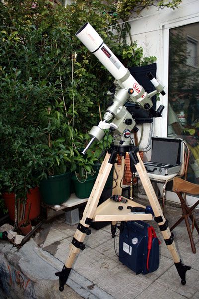

dUbeni
Reged: 04/12/10
Loc: Lisboa, Portugal
Re: Which Berlebach tripod ? new [Re: chrishet]
      #6056306 - 08/31/13 03:40 PM
Thank you people, this thread has been very helpful. I added it to the my favorites a couple years ago because I knew I would need it someday.
So, after acquiring my first refractor (second hand Vixen ED80S, f9) a taller tripod was required, and here it is a truly amazing sturdy piece of wood, a UNI18 with double clamps and spread stopper. I opted for spread stopper because I'm used to it, and I feel it makes any tripod more stable and stiff, two things I like when my companions join me on my observations, the cat Yuki and dog Will, they like to play around and under the tripod, I have to keep them away sometimes.
I'm 5'5" tall (1,66m), not much , for the moment i'm using it at 35" (90cm), but maybe I'll try it 4 or 5" higher next time.
I placed my order on monday the 26th and received it yesterday.
Here, on my current city, under very low transparency but fairly stable skies I watched comfortably the double double and made a sketch. Great first impression.
and here it is:
my city corner on this planet (I have others in other planets )
A great improvement in comfort.
I could go on and on about the things I like about it.
Thank you
