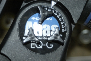

Refractor6
Reged: 10/20/04
Loc: Vancouver B.C. , Canada
Re: EQ6 Altitude Adjustment new [Re: Refractor6]
      #5311594 - 07/10/12 03:57 PM Attachment (42 downloads)
Here's some photos for Ian that started the thread. I see you're in Vancouver so here's the info on where I got them:
Stainless steel bolts at Pacific Fasteners and the matching metric wrench to adjust them directly across the street at Summit Tools...both up the hill on 1 st east of Boundary.
I added some black fabric hockey tape on the wrench for added comfort on the hand for field use.
On a side note when both snugged up now the mount head is completely ROCK SOLID. No flex at all in the head to speak of
P.S. they don't sell any fully threaded ones in metric sizes with hex wrench tool ends so don't even ask
Photo #1
M10x90 F.T. bolt
