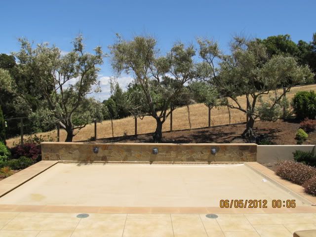

Re: CGE Pro: Anyone have a good one? new [Re: bilgebay]
      #5359050 - 08/09/12 12:36 AM
I love your patio. What a great view. It seems like our climates and tastes in stonework are not all that different.
I concur that the Vixen US practice of stating capacity with CWs included is a bit misleading, especially since the mother ship in Japan does not rate the mounts that way. Though I will say that Losmandy states capacity both ways - with and without CWs, so it's not entirely unprecedented. And Starbook is stupid. I wish the Starbook mounts were Sky Wire compatible. Still, if it tracks smoothly it's not all bad.
- Jim

      #5359079 - 08/09/12 01:15 AM
Thank you Jim. Your place is beautiful too. When I visited Berkeley, Napa Valley, Point Reyes and many other places last year, I came to the same conclusion. I felt very much at home in your country.
