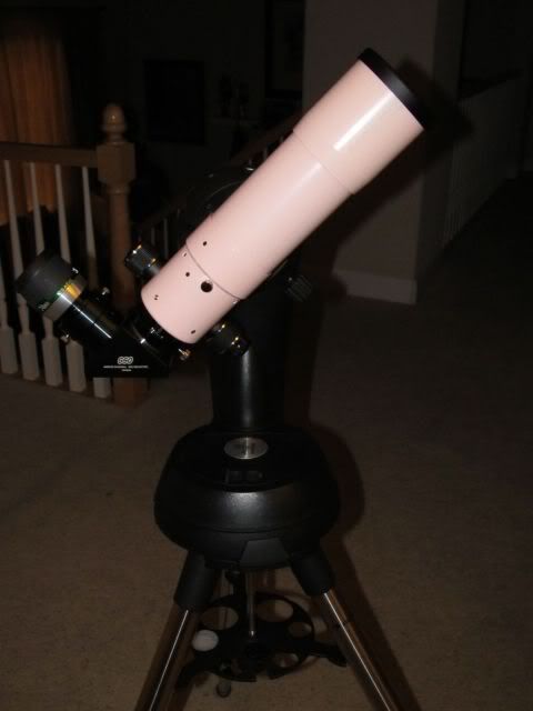

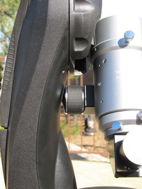

The AT72ED barely clears the arm and the top of the base on the larger 6/8 SE mount. I have my doubts that it would clear on the smaller Nexstar mount.
That's a $450 mount, but it does provide GOTO and Celestron's excellent Nexstar software. You can also use Sky Safari with a Sky Wire to operate the mount from an iOS or Androis device (phone, tablet, etc.) which is pretty nifty. One thing potentially that you could also do is extend the stock short dovetail on the scope by bolting on a second vixen dovetail beneath it, to increase the focuser knob clearance.
Here's a picture of my AT60EDT rather than my AT72ED on the mount illustrating how tight the knob clearance is with focuser in conventional layout, with a smaller scope than the AT72ED:
The AT72ED won't clear unless you mount it with the knobs as shown in my first picture. But with an extended depth dovetail, you might be able to increase knob clearance enough.
Yeah, my AT72ED is pink. Your eyes didn't trick you.

Thanks Jim for the info and pics ... considering the tight fit, maybe I will consider the Celestron/Skywatcher Allview mount, similar payload as the small SE mount, but scope can be mounted on the outside of the one arm fork ...
Oh and a pink scope, I must not let my 4 year old daughter see that one, she will so want it ... and put a "hello kitty" sticker on it :-)))
