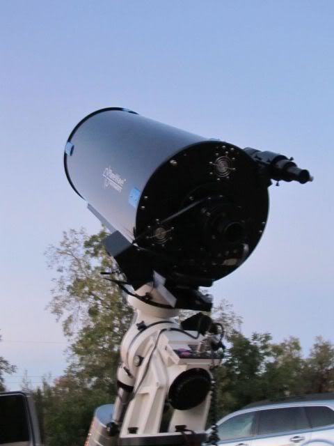

      #5470227 - 10/14/12 05:34 PM
And I have to post these...
Planewave 12.5" Corrected D-K on AP-900.

      #5471389 - 10/15/12 11:52 AM Attachment (64 downloads)
I have noted that on the high end scopes more consistency of quality. The descriptions very here because more than likely the scopes very as well. Jim's description of his scope soundl like my Orion 120 ST, that is why I cut 5" off the tube and made it a dedicated binoscope. My AT 152 with Chromacor edges out my IM 703, and clearly beates my 8" Meade SCT.
Edited by doctordub (10/15/12 11:58 AM)
