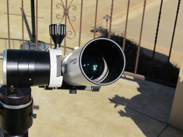

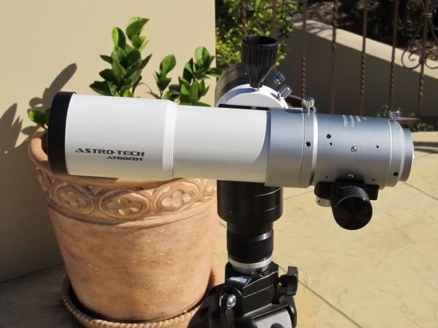

Re: Astro-Tech 60mm f/7 ED triplet, first report. new [Re: jrbarnett]
      #5491861 - 10/27/12 03:43 PM
The new R&P locking focuser:
The bidness end. Note that it, like the AT72ED but unlike the AT111EDT, cam with a little bit of dust between elements.
      #5491872 - 10/27/12 03:58 PM
The AT60EDT has a single thin baffle near the objective end and a highly textured flat black interior the rest of the way down rather than multiple baffles like the AT72ED.

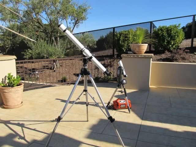

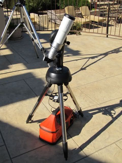

Re: Astro-Tech 60mm f/7 ED triplet, first report. new [Re: iceblaze]
      #5491985 - 10/27/12 05:38 PM
Jup.
I have 'em both set up and ready to rumble. Luna and some doubles on the menu for this evening. No holds barred up to 140x. Carton on the Teegul and AT60EDT on the Nexstar SE. I'll be working with the Televue Plossls and Nagler Zoom (3-6mm), and a Barlow or two.
I'll go get some pics. After all, a pic is worth at least 1000 words.
- Jim
