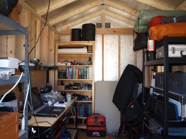

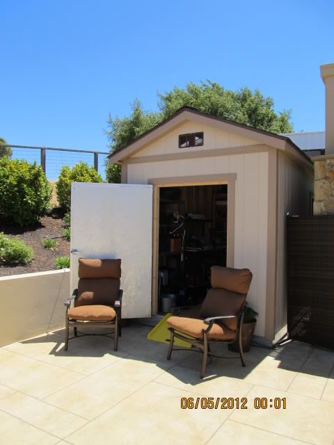

Re: Storing Scope in Garage new [Re: dgmoses]
      #5646861 - 01/27/13 08:20 PM
I store my stuff in a shed.
No problem. But I did a few things to mitigate heat. First, I have a ridge vent on the roof as well as vents front and back centered under the eves. Second, I went with a reflective treatment on the interior walls. I talked to a guy in El Paso that has two sheds, one with this treatment and one with bare wood walls. He told me that the treated shed ran about 10 degrees cooler than the untreated one. Lastly, I went tall to create extra air-space at the top with the vents. Heat rises and I wanted the hottest air above well above all the gear.
I'm very happy with the solution, and it isn't all that different than a garage. We get some heat in summer, but humidity is low. I'd worry more about moisture than heat with optics and electronics, to be honest.
