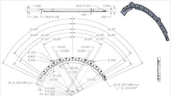

Okay now Ron, did you have a mole in our organization last summer???
This is an early design drawing from July:
1/3 arch segments with Lap Joints! And we even had one variation where the feet shafts went through the lap joint! So, either you've been doing some spying Ron, or maybe great minds just think alike.
We did make up prototypes from this design, as well as a few other variations. But when all the dust settled we decided that the 1-piece design was the overall winner for various reasons. But boy did I beat my head against the wall for what seemed like an eternity trying to decide on an optimum design. I'm EXTREMELY happy with the way the product has turned out, and I think we did choose the right design in the end. But there are certainly other ways that the HALO could have been realized.

I've never done a segment; always felt a monolithic design was stronger; an easier to make. On the other hand, all that waste in the middle of the cut out drives me bonkers.
But it hardly takes a mole; these are tried and true fabrication methods in woodworking. Especially if you follow Chris over on Popular Woodworking. But hey, always nice to have several ways to skin a cat.
Same here!
Yeah I was just kidding about the mole. But I was pretty surprised when you mentioned a design concept so similar to one of our early prototypes. I don't follow Popular Woodworking, and I guess I didn't realize that it was common practice to make ring-shaped things out of 1/3 segments with half lap joints.
And we certainly tried every other way we could think of to skin the cat. Our silliest design idea that quickly ended up in the trash can was a segmented design where the pieces had interlocking puzzle-piece type fittings on the end. Looked like a piece of Thomas the Tank Engine track! My kids REALLY liked it, but it didn't take long to realize it wasn't a great idea.
