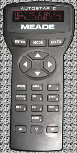

Well, now the second night the scope worked fine. But last night I got weird displays on the handbox, complete nonsense like a part of the display was not working.
Then I got a "Software Downloading Do not Turn OFF" display.
I shut it off since it was a spurious display (not connected to internet at the time).
This morning I turned it on and got more weird displays, intermittent "Proc. Trap 2" displays. As I understand that display is similar to the Apollo 11 "1202" alarm, a program overload.
So it took the base plate off and blasted the circuit boards with a hair dryer set on high to evaporate any residual water in the base. I then started the AutoStar Updater program.
At this time I am completely replacing the OS with a fresh copy of 4.02g and will go from there. Fingers are crossed....
Well now that it is done downloading, it works fine now.
It took over 30 minutes to download the entire program, so I had time to have some PhotoShop fun, with a new revision to the software for when the Autostar gets wet...
Obviously, the LX200GPS base assembly and circuit boards are very sensitive to water contamination. I have been using this system for two years now, and I am the third owner.
I am living now in a very mild climate, southern California. I will be moving to New Hampshire, far from the Meade Irvine facility. I wonder how well the scope will hold up in sub freezing weather...
