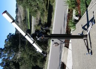

      #2977503 - 03/11/09 11:03 AM Attachment (67 downloads)
My Atlas worked quite well on an A-P Portable pier. The guys at ATS created the adapter and it was a nice setup.
Ron

      #2979218 - 03/12/09 08:23 AM Attachment (78 downloads)
How do you deal with the hold down bolt? Or is it verrrryyyy long?? lol
Actually, I used the stock bolt. The adapter was bolted to the Atlas and the whole assembly was placed on top of the pier, then held on with the usual wing bolts. The adapter is actually small and light.
Here's a better picture of the rig set up with my C925.
Ron
