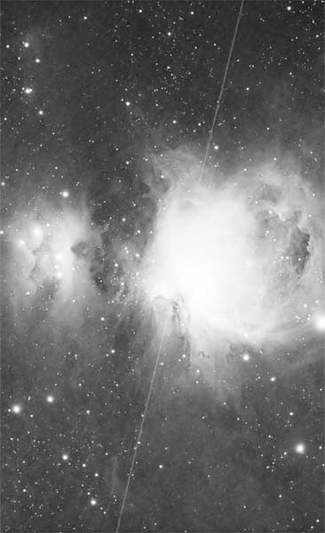

So, I shot the orion nebula this weekend for the 2nd time, and again, I got satellite streaks in the photo. The imaging time was from 1:40am to 2:20am Pacific Time. Now, I always thought that satellites were reflecting sunlight down at us, and that created the streaks. I understand its very common 1-2 hours after sunset, and 1-2 hours before sunrise, but how can this happen at 1am, when sunset is at 7pm and sunrise is 7am?
Anyway, I digitally removed the streaks, but I'd still like to understand where the satellites were being illuminated from.
The brightest streak took nearly 9 minutes to cross the frame from top to bottom, so I assume that one was a Geosynchronous satellite....still seems like it should have been dark tho. Possibly this exact same satellite crossed orion last month when I was imaging it, as again it took 9 minutes to cross the frame.
Here's a b/w preview version showing the brightest 9 minute long streak before I digitally removed it:
The results (after removing the streaks) are here:
Bigger Version Here

Satellites can be seen at any time of the day or night. The ISS is only seen at the limited times you mention because it has such a low orbit (~300 km) that it is often in Earths shadow vs geosynchronous (~35,000km) which are almost always illuminated.

A quick bit of maths (without a calculator) seems to result in a period of well over 24 hours, but more likely a slower speed during that part of the orbit, ie highly elliptical. That might indicate one of the US communication satellites (seeing as you live in Ca) - thats a guess by the way
I'd be kinda shocked to think that a satalite 22,000 miles away could be seen in a shot at 400mm though. Does that seem right? It must be gigantic if thats the case.
Even if the sat isnt in an eliptical orbit (Seems strange that it would be) it still makes sense that it'd leave a streak since the earth and the satalite are both rotating, but the starfield is not, and thus, it will appear that one is streaking past the other.

It is kinda weird I agree, but we're using very sensitive cameras these days and satellites are very reflective. Geostationary satellites pop up all the time in images. An easy way of determining if you got one is to simply turn off your drives on the mount. The stars will streak, but you will end up with dots for the satellites (the opposite of what you got). You may even see a few in a dead straight line.
Eliptical orbits are used to ensure that a satellite spends more of its orbit over one location eg US. The eliptical geosychronous orbits (vs equatorial geostationary orbits) are used when you need north/south movement - This is when its at its furthest point and travelling the slowest - thats why I think its one of yours. Another check that its geostationary is - Is it south from you? - eg above US again. Geosynchronous satellites can almost be as far north as the artic circle.
Have a look at this
http://epod.usra.edu/blog/2007/09/geostationary-satellites.html

Man, there's tons of them lined up there in a row. No wonder I've gotten 2 through my Orion shot both times I've tried to get 1 hour of data. It must be that orion passes right through the lane of them at the time I'm shooting. Doh!

It is extremely hard to image Orion without getting at least one satellite in the picture.

Agreed. Orion is a satellite magnet. You'll constantly see streaks through there. You should go find your raw subs and sequence them in a gif file to animate the motion. If you have the precise times, you could potentially look up the object and then label your image which would be pretty nifty.
