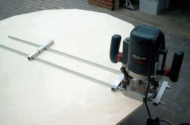

Here's my router setup using this technique for cutting some upper cage rings (about 45" diameter). The jig uses two long 8 mm threaded rods, some Alu tubing, and a 6 mm bolt as center pin. Works very well!

What a sleepless night. I just woke up at 2:30am from a dream, and can't get back to sleep.
Today we dropped off the tailgate for welding. Some friends of my wife's are doing it in their free time, so I should have it back in about a week. Those guys are awesome!
Also went with Protostar for the secondary. I emailed around to several of the major vendors, and theirs seemed to be the best available in a reasonable time frame. Hopefully that'll show up in a week or two.
-Brian

Wow, its been a long time since I updated. Sorry about that. Got some good work done. This one is going to be pic heavy.
Here is the tailgate back from welding, getting painted in our garage.
The guys did a great job. The rectangle pieces we got weren't exactly straight, they were slightly warped, but the jig I bulit held it in place well and they got it welded in. It is nice and square.
Next order of buisiness was to build the upper truss clamps. I went with the same design as on my Astrosystems.
That allowed me to get the upper cage assembled, formica installed and the focuser mounted. It is squared, but I still need to center my spider.
I think the look is coming together nicely. The wood looks good against the marble finish laminate.
The next order of business was to build the mirror box. Its 9" tall.
Next order of business is going to be to build the lower truss clamps. I have a ball mount design in mind that I'm going to save sharing until I know if its feasible or not, lest I look like a fool.
More soon I hope!

Well, I did indeed outsmart myself on the lower truss block design. I had hoped to use a ball socket down there, but I've found that I just can't get enough tension on them to hold the ball in place, even against just the weight of the 7' long truss tubes. I started to get visions of the whole upper cage and truss assembly falling off, and that went bad places. I had ideas on how to hold them in place - a couple of pins would do it, but the design just seemed to get more and more complicated, and what I thought I was doing when I started was making it simple. So I think I'll be changing direction. I'm going to use a grealy simplified split block. Only it won't have a split. It'll just be a hole bored in a piece of hardwood to fit the truss tube. I'll drill another hole in the side of the block perpendicular to the tube axis, sink in a t-nut, and use a small threaded rod with a handle on it to hold the tube in. This will attach to the mirror box with screws. I'll have to put one screw in until I get the tube angles set, then add one or two more to hold it in place, and I may have to shim it 'out' a bit to line up easily with the upper clamps. These are things I was trying to avoid with my ball socket idea, but oh well. It isn't insurmountable.
Some money wasted on materials, some time wasted on putting them together, but I'll chalk it up to R&D expense.
I'll get some pics up once I have a prototype.
