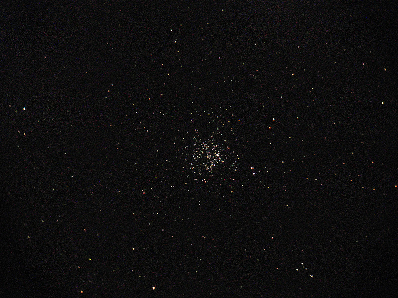

I have reactivated this thread as the Canon Powershot is still viable and used by many budget astroimagers. Further technical discussion is encouraged along with posting of images.
Canon Powershot series only, please.
Here is an image of the Wild Duck Cluster I took last night at Post Pond Meadow, New Hampshire. Post Pond is located in a Bortle 3 (blue) zone in the Northwest portion of New Hampshire.
The image was taken with a Canon Powsershot A620 with a Scopetronix adapter connected to a Scopetronix 40mm 2 inch eyepiece, which was inserted into a 2 inch Williams Optics diagonal on my 10 inch Meade LX250GPS Frankenscope. The mounting was in Alt-Az mode The camera was controlled via USB cable with Canon's RemoteCapture 2.7 program with the following settings:
Shutter Speed: 13 Seconds
F-stop F2.8
7.3mm focal length
Manual exposure mode
Manual White Balance
Historgram compression in Adobe Photoshop CS1
RemoteCapture's live view was not usable for focus at all due to the dimness of the subject. So focusing was done in the blind with multiple exposures until proper focus was achieved (about fifteen exposures)
Ambient temperature was 28 degrees F.

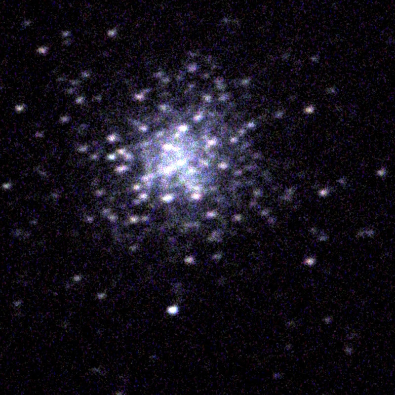

M15 Imaged from Lebanon, NH, USA
M15 Globular Star Cluster in Pegaus. October 25, 2009 22:20:12 EDT
Imaged with Canon A620 Digital camera attached to a 40mm 2 inch EP on a Meade 10 inch LX250GPS SCT Telescope.
Ten images stacked with Registax 5.
15 second exposures
F4.0
Focal Length 21.71mm

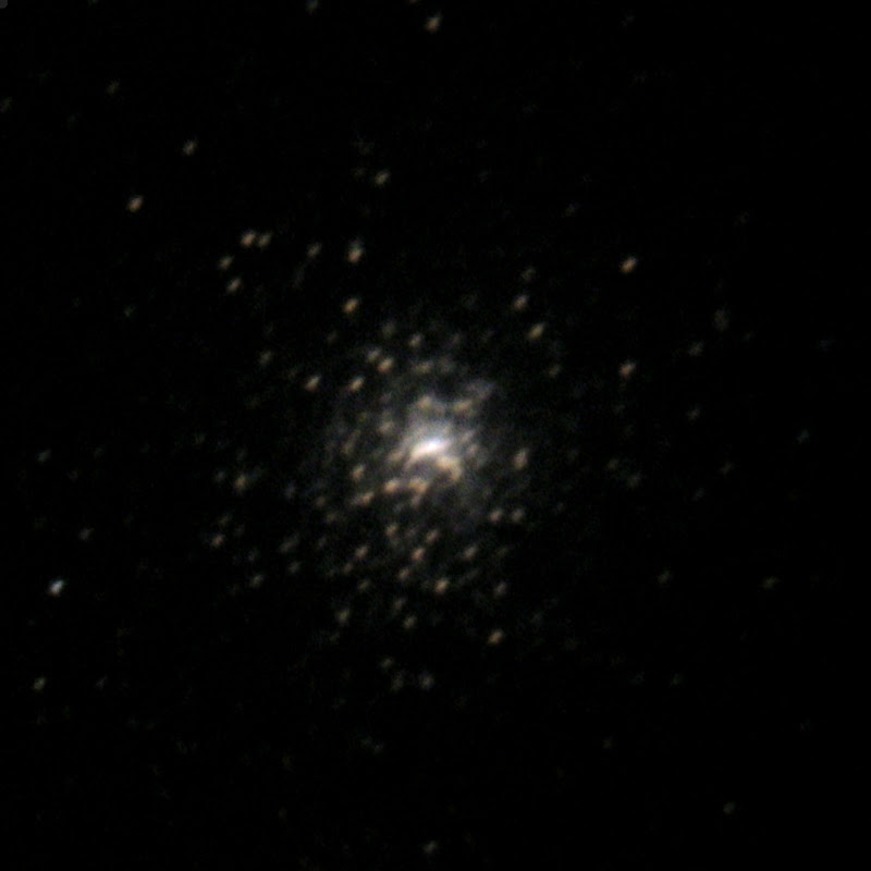

M2, Globular Star Cluster in Aquarius
October 25, 2009 23:09:57 EDT
Imaged with Canon Powershot A620 Digital Camera with a 40mm EP on a 10 Inch Meade LX250GPS SCT telescope.
Ten images stacked with Registax 5.0
15 second exposures
F4.09 Aperture value
29.20mm Focal Length
F number 4.10
