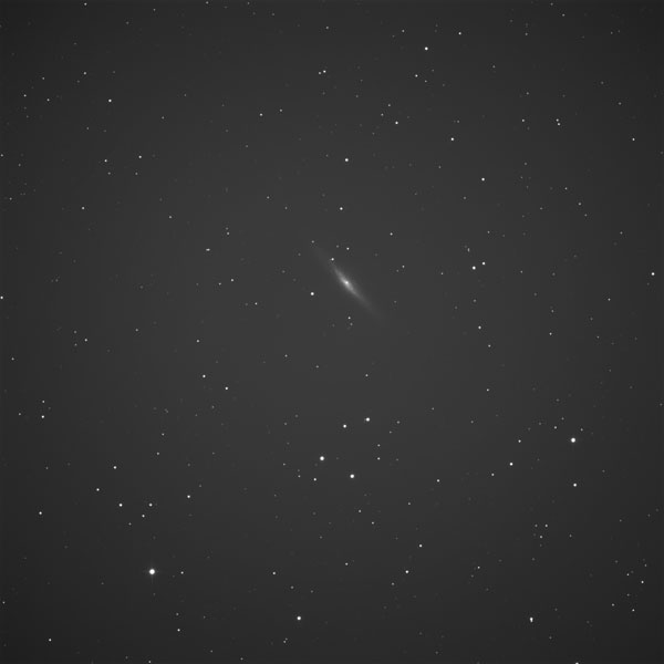

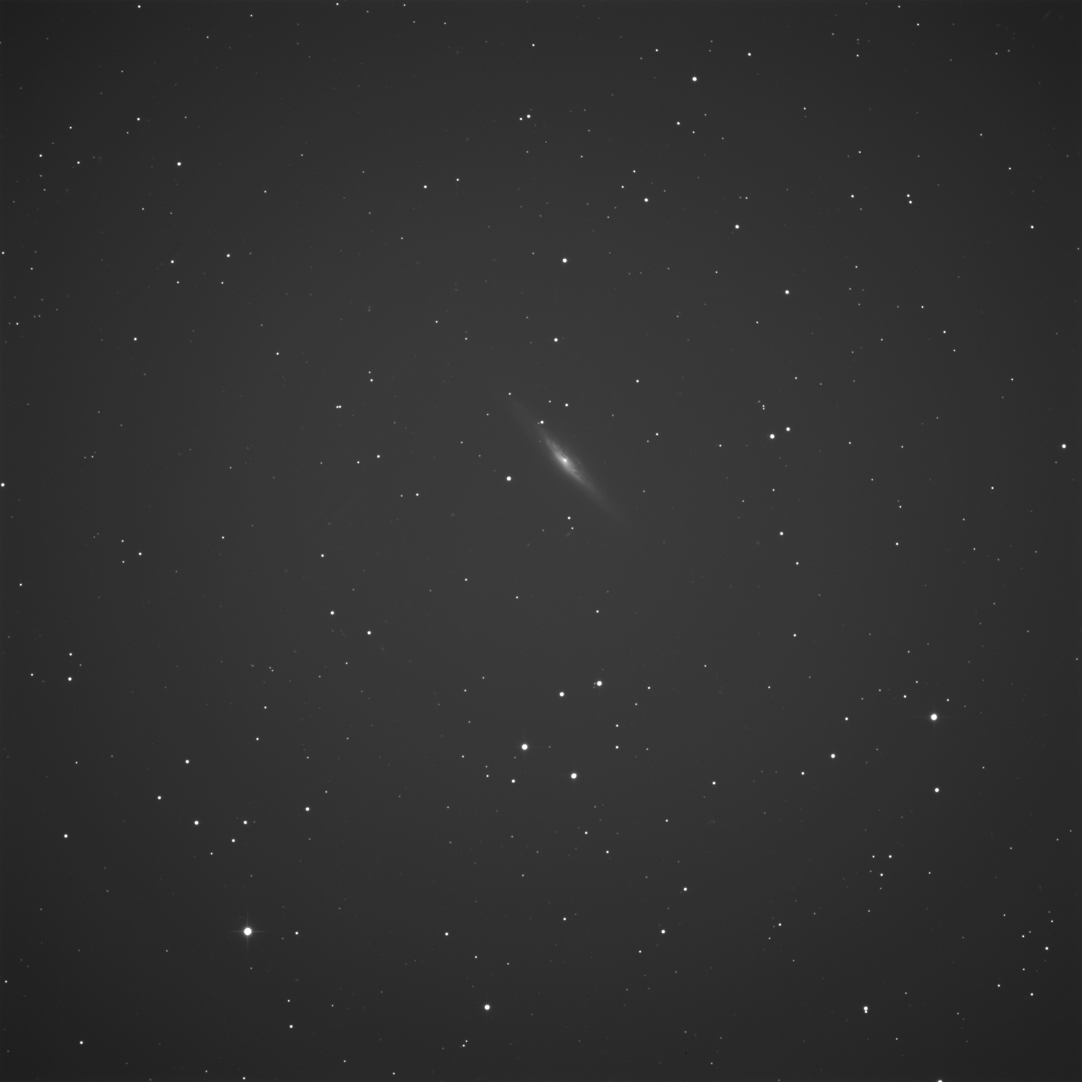

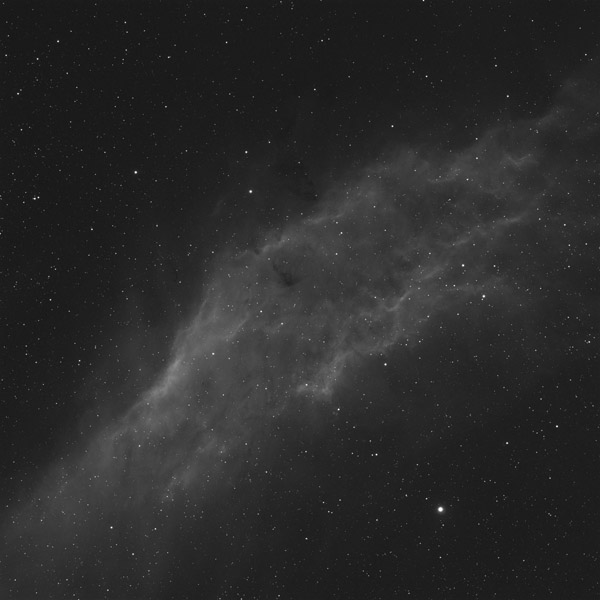

Do you detect any severe guiding problems in the following raw-images?
Autoguiding was done with an off-axis guider and a SX lodestar cam. Location was my city-balcony, surrounded by many other houses.
Mount was a 10micron GM2000.
20 min H-alpha-frame with TEC140 (980mm focal length)
FLI ML 16803-65 cam with 9µm Pixels
full res
20 min luminance-frame with Planewave 12.5" CDK (2541mm focal length)

Please check out my gallery at www.stern-fan.de for further pics.
