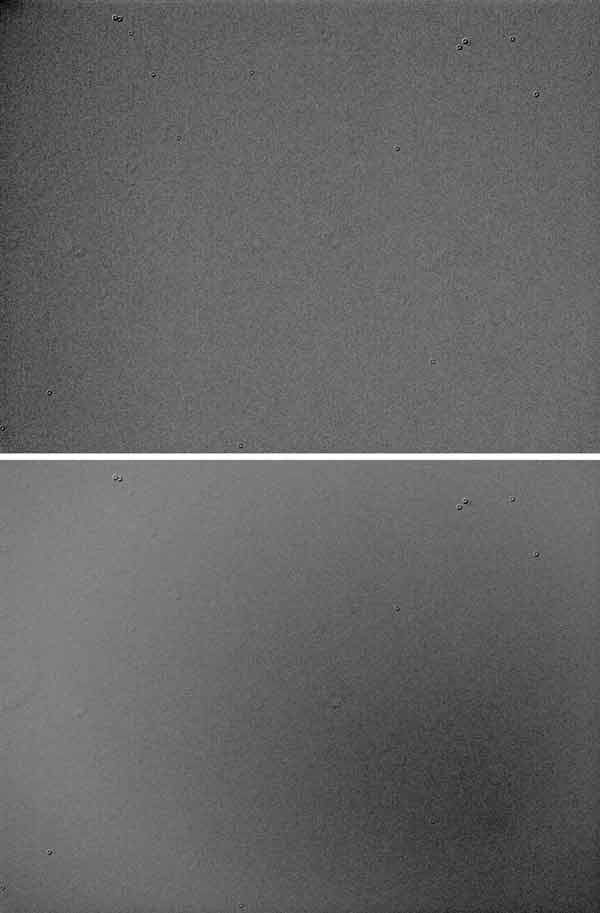

Image6: Base/Control and Base/Out of Focus combined in photoshop and extreme stretching applied to compare
Conclusion:
The level of stretching that I applied in order to identify a change between the control and out of focus images was much more than I would ever apply to actual data for an image. My conclusions for this SCT:
1) Dust donuts are not significantly affected by focus.
2) An out of focus flat is much better than doing no flat at all.
3) Focus will affect your flats, so try not to change focus between your imaging and your flats. But don't worry too much about it!

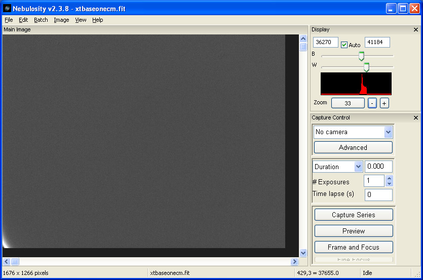

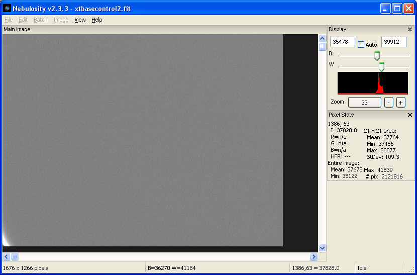

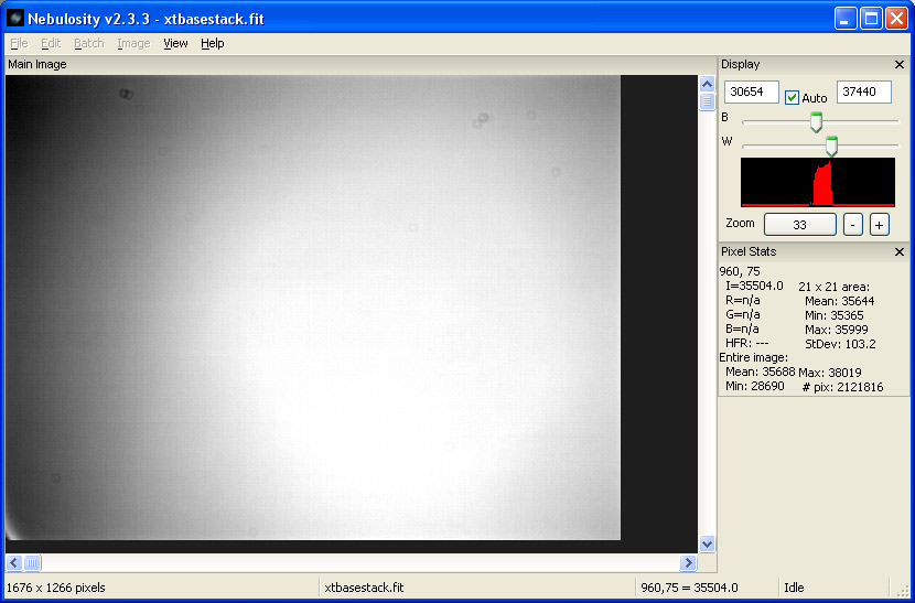

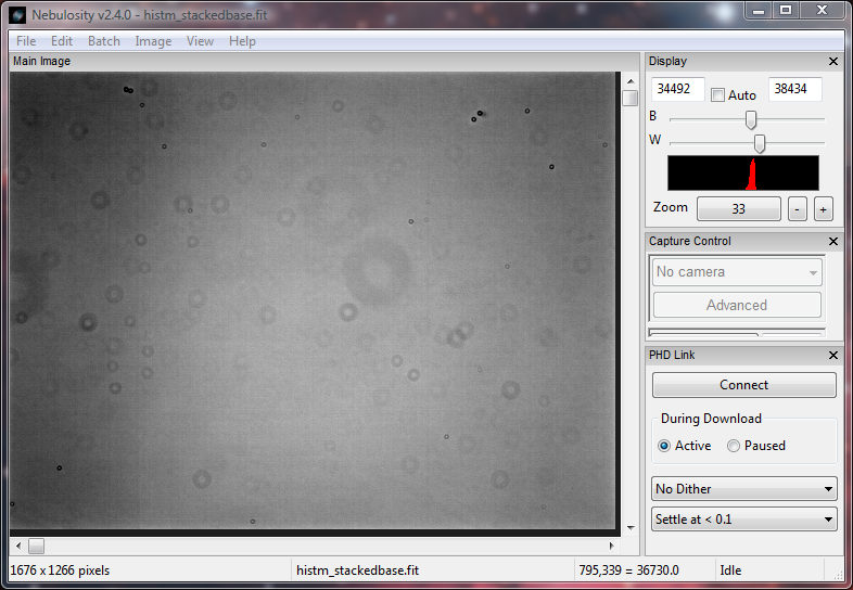

Newtonian results:
I took my XT10 OTA into my observatory to test focus with this newtonian.
Here is my base image:
(The dark spot in the lower left I believe is frost. It's time for me to change the desiccant again- this spot disappeared when the camera was running for several minutes)

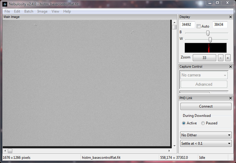

Base with control as flat:

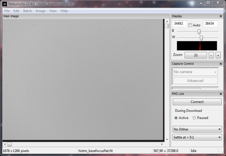

Base with focus racked out all the way (for my newtonian, focus is racked nearly completely in)
The large dark circle may be a shadow from the secondary mirror, but I'm not sure.

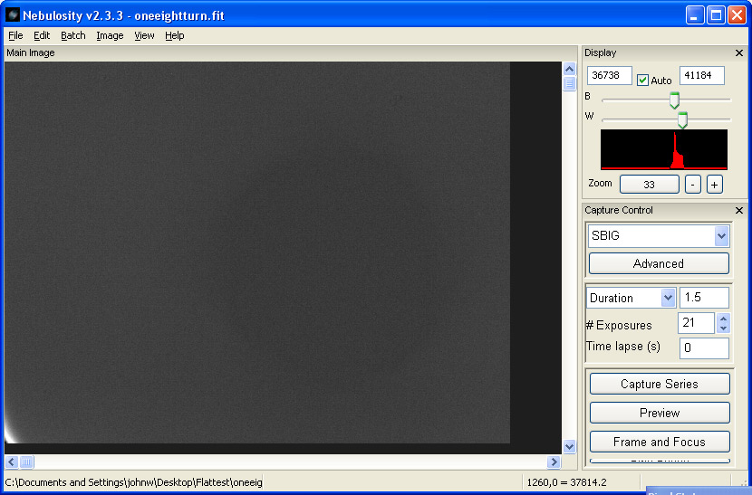

Next I tried a stack with the focuser 1/8th turn from correct focus:
Still significant problem here.
Finally I did a test with a 1cm turn. This would be a typical temperature-based focus change for an imaging run:
Luckily this time there was only a hint of the circular artifact and I don't believe it would cause much of a problem.
Conclusion from this: This Newtonian scope's flats MUST match the lights focus.

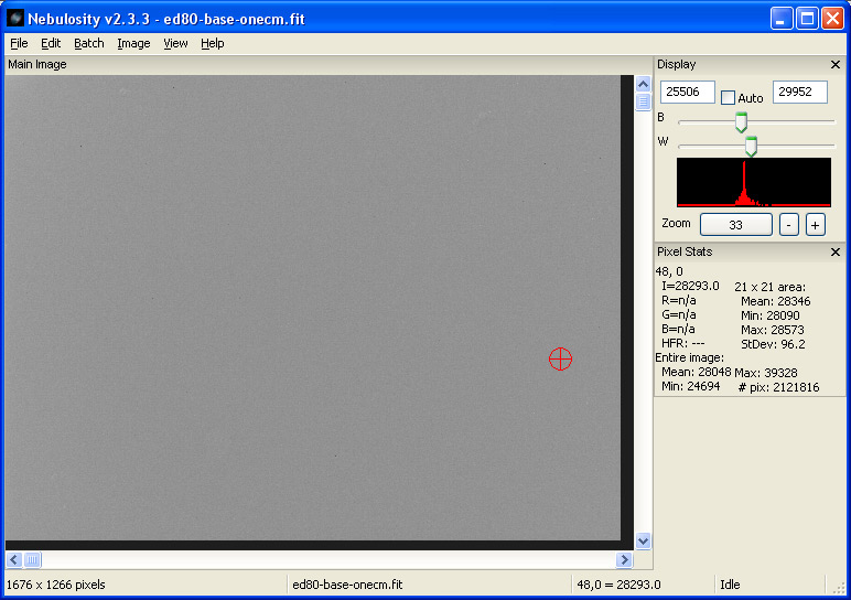

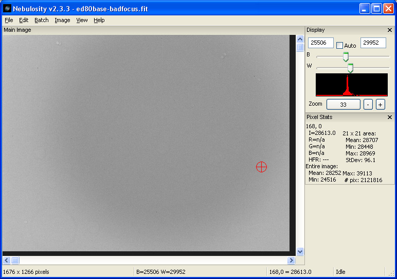

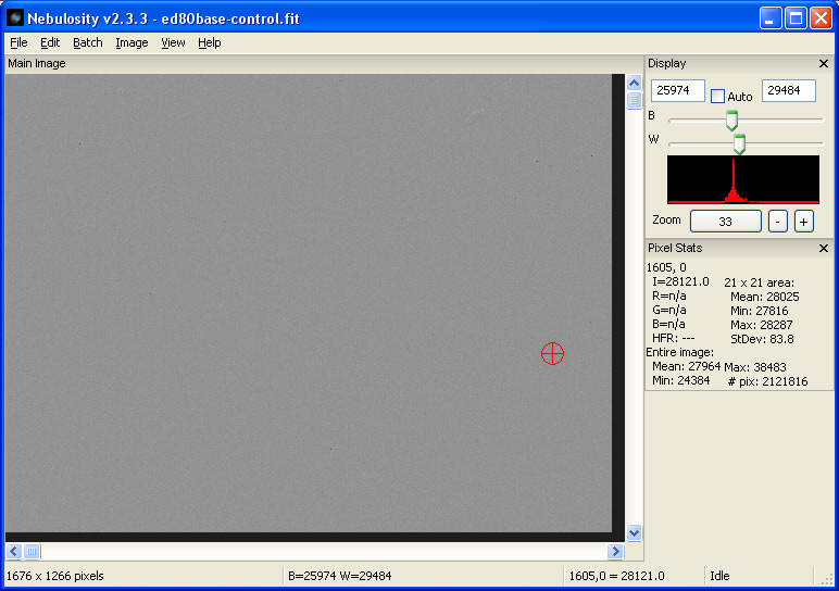

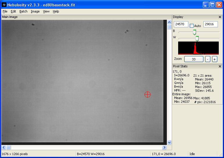

Refractor results:
I almost forgot I have a perfectly good ED80- I usually just use it for guiding
Base image:
Control as flat:
Fully racked out:
One centimeter knob adjustment:
Conclusion:
My ED80 was closer to the SCT than the Newtonian. There is a slight change in vignetting between the images, but I would again say an out of focus flat with this scope would be better than no flat.
