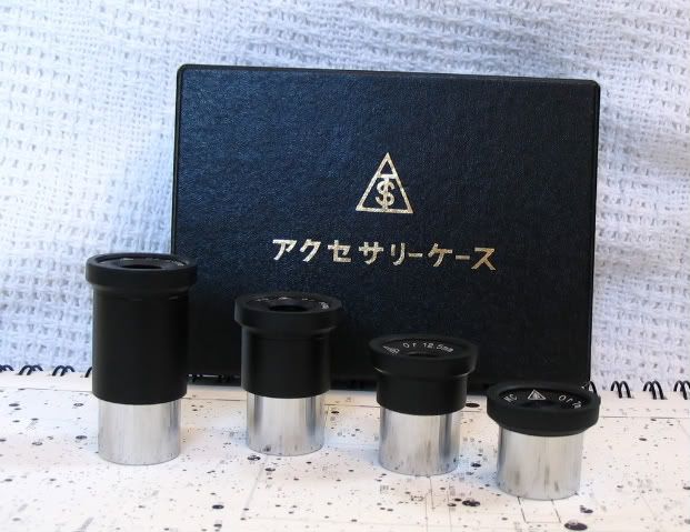

Re: 0.965" Eyepieces new [Re: Nuphy]
      #5342437 - 07/29/12 09:49 PM
Hi Nuphy.
I bought the boxed set used on Astromart. It includes a 7mm, 12.5mm, 18mm and 25mm. I've since added the 2.8mm and 4mm Hi Orthos, and the 32mm MC Erfle. I'm debating whether to finish the set (with a 5mm and 9mm) or sell the set as I have the full set of 0.965" Pentax SMCs (with also a 3.8mm XP thrown in, but not pictured).
