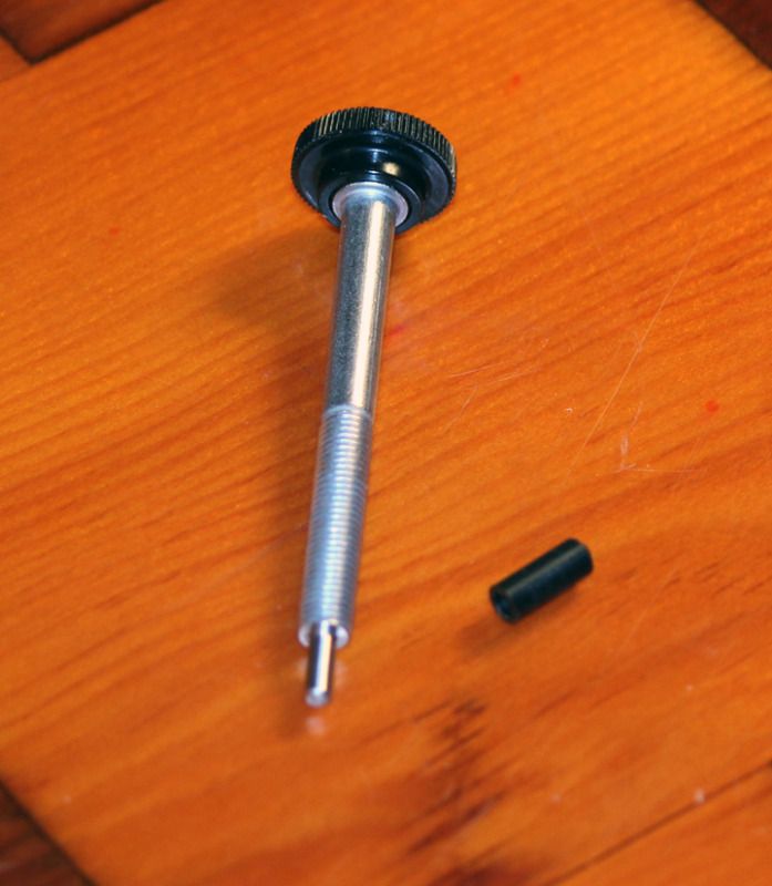

Here is a picture of a Delrin tipped SS thumbscrew I made from a 2.5” Ό-28UN SS SHCS, 3/16” diameter Delrin stock, Ό” Shear-Loc press-on Thumb knob and 1/8” ground SS roll pin. All parts were purchased from McMaster-Carr. I might add that when using DIY thumbscrews I find it best to use an oversize tap when making a threaded hole especially when using Nylon screws. E.g. for a 1/4-28UN hole I use a 1/4-28UN H6 tap. For every H value on a tap the tap is oversize by 0.0005" so an H6 tap is 0.003" oversize.

The Ύ” length 1/8” diameter solid SS ground pin was pressed into a 3/8” deep 1/8” diameter hole in the end of the Ό-28UN SS SHCS. The 3/16” diameter ½” long Delrin part is bored with a 1/8” hole in order to slip onto the pin at the end of the screw. A 45 degree chamfer is machined in the end of the Delrin part. The chamfer and the rigidity of the SS 1/8” pin allow this thumb screw to bear against a circular groove on a part which has a similar 45 degree chamfer so this thumb screw not only puts pressure in the axial direction but also pulls the part towards a machined land, holding the part in two directions with one thumb screw.Here is a photo of the 1/8" pin at the end of the SHCS with the Delrin part removed.

There is no off-the-shelf equivalent that I know of or else I certainly would have bought them instead of making them. This screw was made to solve a specific problem. Yes! SS ( apart from 303 SS) is a bi#%h to machine. I use coated carbide insert tooling for turning and either a solid carbide MA Ford 135* splitpoint drill or cobalt HSS 135* splitpoint drill to make the hole. Also, IMO great smelling bacon grease does work well but I got a great deal of $5 for 5gallons container (for me a lifetime supply) of Mobilmet Omega cutting oil. Oh yeah I still have a can of original TapMagic fluid with 1,1,1 Trichroroethane that works great on all types of SS however one must use a respirator if one is concerned about one's health.
