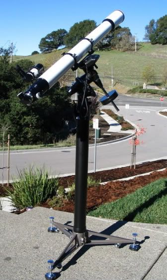

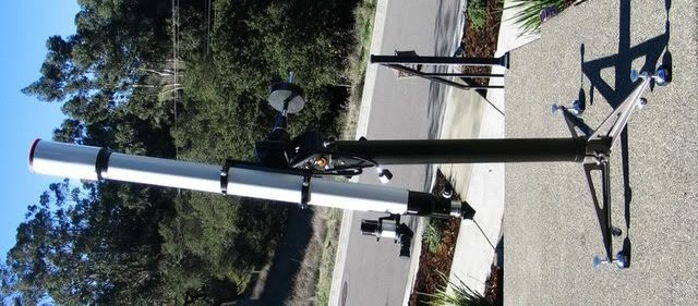

Re: Antares 105mm f15 elite new [Re: nightfisher]
      #5485620 - 10/23/12 04:46 PM
105/1500 on a CG5 with Antares 48" Pier:
I also now have the 60" version of the pier and prefer it for the following reason:
The CG5 mount with VSPs is good enough for this long but very lightweight OTA.

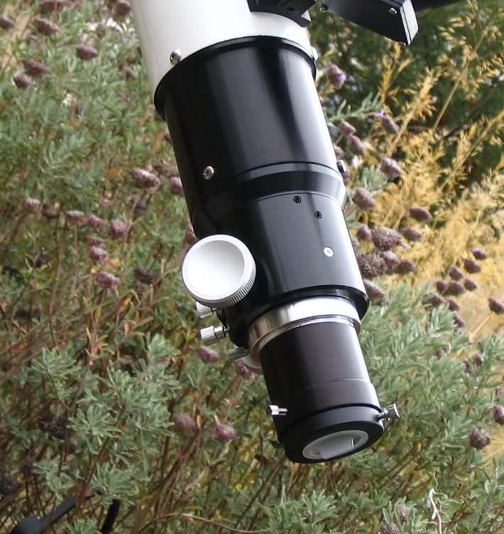

      #5487159 - 10/24/12 03:15 PM
Jules, mine came with the GSO dual speed Crayford, which I eventually replaced with a GSO single speed Crayford, though I also have a Synta 2" R&P on hand that I may give a go on the scope. It looks like it will bolt straight on.
As for outfocus, yes the 1500mm f.l. units were deliberately built a bit short. Originally they shipped with a 2" long extension tube with a 2" compression fitting. You can see that here:
I typically use a 1.25" Vixen prism diagonal with mine, though I have also used 2" mirror diagonals with it. With the prism diagonal at least, the extension is a "must use" item.
Another little trick I recommend is using a high-bond epoxy or similar to permanently affix thin metal washers around each of the three holes where the rear assembly attaches to the main tube, to reinforce the rather thin walls at those stress points.
