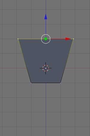

Now we are going to resize the top a bit. With the same vertices
still selected, press the S key. That is a hotkey for resizing something. go
ahead and strectch it out to the width of 5 units.

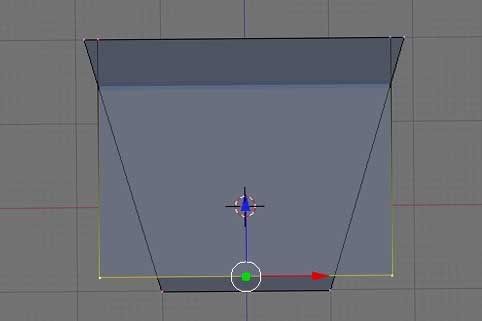

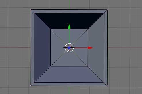

Next we are going to do another extrude.Go into top veiw(numpad
7).Press the E key again and select the "edges" option, then press
the S key again. Reduce the size a slight bit
OK, now we are going to extrude once again...Didn't i tell you
that you would do this alot... This time we are going to constrain the extrude
to one axis.Go into front view (numpad 1). Start to extrude as normal, and if
you push the Z key it will pop up a highlighted blue line (that would be the
Z axis). Extrude down to just shy of the bottom of the pot.
Now we need to resize again. Hit S and scale it down.
Last extrude for this one . Go into top view again. Start extruding
and then resize( E then edges then S) aqnd while resizing, if you press 0(zero),
it will reduce down to a singularity.

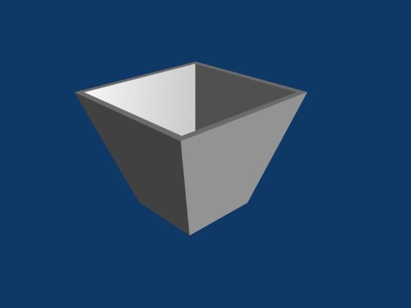

Congradulations, you are done with the model!!! Now we just need
to fix the lights up real quick, and then render.To do that, hit Tab to go back
into object mode, and then right click the lamp. Once it is selected, press
F5, which will open your shading panel. select HEMI. Now, if you press F12,
the scen will render. If it looks OK there,m press F3 and it will ask you to
name the file. It will be saved as a JPEG.
Here is what mine turned out like
OK folks, I guess that wraps this one up. Untill next time........
