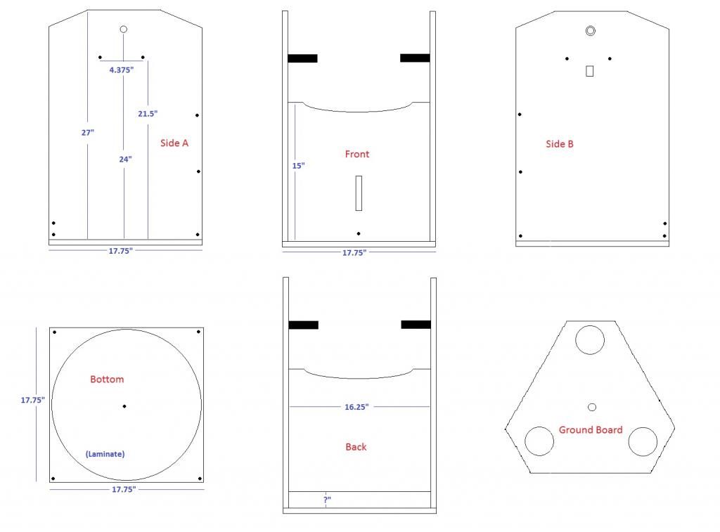

Here's my rough layout thus far:
The measurements I've included are ones I think are somewhat important to keep consistent with the existing base.

      #5534696 - 11/23/12 12:58 AM
For the love of God man! Don't do that!!!!
I would laminate the entire bottom of the rocker box.
pdfermat
Reged: 11/12/07
Loc: Wisconsin
Re: The Orion project... new [Re: Pinbout]
      #5534703 - 11/23/12 01:09 AM
Indeed you are correct - why wouldn't I want to laminate the entire bottom? Much easier!

      #5535005 - 11/23/12 08:29 AM
The base of my 6" f8 is 17 inches in diameter. I can't imaging putting a 12 inch on a disk that small. I'd say 22 inches is a minimum. Try to put the side walls of your rocker box above your laminate ring, rather than outside it.

      #5535531 - 11/23/12 01:34 PM
allan
That footprint seemed kind of small to me as well, but I was going off of dimensions I saw from Obsession's 12.5" rocker box. I've increased the bottom dimensions to 22"x22", which has also allowed me to put some "wings" up the sides like Orion does on their xx12, which should also help the flex problem.
Here's version 1.1:
