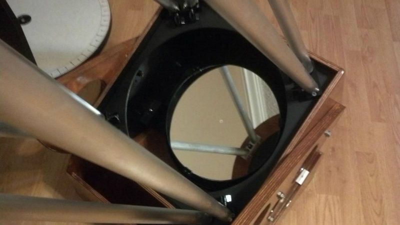

After visiting with and ordering a AstroSky 16 inch dob from James I think I was inspired by the aspect of building wooden truss dobs and started to wonder about my 12 inch Zhumell that I really only use at home in my light polluted skies.
For me it is just too long and unwieldy for the small vehicles that I own, but I am totally impressed by the views it can produce.
I have a Z10 also and that has been my goto scope when I go to a dark site. But, I don't feel like I am getting my moneys worth out of my 12.
So after much research and reading I decided to give it a go. This would be my first scope structure build. I plan to reuse as much as possible from the Z12 "Carcass". Eventually I decided to use some from the plans from CN member "Pinbout" Danny. which he has freely posted numerous times in posts.
So thanks Danny. Your plans work.
I also used other examples all over the net, and some from "The Book".
I reused the spider, holder, secondary mirror, primary mirror and cell. The focuser is a moonlite CR1, truss poles are 1 inch alum., lower connectors are moonlite, uppers are DIY with bicycle quick release. The moonlite connectors are a dream to use, and the quick release work great. I found examples of those on the internet.
It riding on FRP with Astro Systems bearing kit and pivot kit for Azimuth. Altitude is Ebonystar on Astrosystems teflon.
I am not finished yet still have do a few other things, shroud, electrical, dew heater, finder, so on.
It is definitely not perfect. I had a few mistakes along the way and some are still visible, but the end result is the scope balances well, is smooth, collimates easy, and most important I am happy with it. THX.

Brian, thanks for the comment. The top ring has a little bow in it from the plywood warping when I purchased the wood. I didn't notice it till later. The circle is fine just one lip rides up more than the other. The bottom ring is fine.
Also I doweled the struts to the rings and when I sanded I sanded too much and sanded through the veneer. I located the altitude bearings wrong and had to redrill. You can see the off white dots in the pics on the bearing. It is filler and as a reminder to myself I decided to poly over the filler without staining. I did that on purpose adds character.
There are a couple other things like that but they are minor. And hopefully I will learn from them. THX

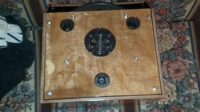

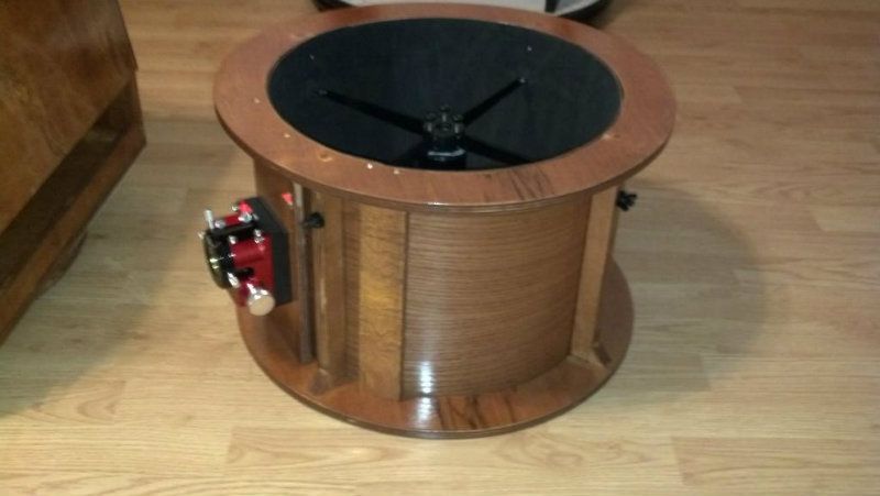

Here's a couple more shots of it.

I was able to star test my rebuilt scope last night. Tonight it's cloudy. All my eyepieces come to focus! The first time I tried this they all came to focus but I did not have much inward travel left. So Newt called for cutting almost 3/4 inch off. Which worked out.
I did not have much time to observe and it was cold out and my fan was not hooked up. But, after an hour or so my mirror gave great views of Jupiter and the Orion nebula.
Vibrations were very minimal almost nonexistent actually. The old mount would vibrate for 2-4 second after touching the scope. It was very easy to track Jupiter at 300x. I did not experience any backlash or stiction. I still haven't waxed either bearing. So I am curious what this will do. I may not even do it until I start experiencing problems.
I do need to get a shroud soon. Just have not decided who's to go with. I wish I could sew and make something that would look decent.
Tonight I finished the wiring on the fan and batteries. I bought a cheap float charger from Harbor Freight on sale for Black Friday.
I was very impressed with how the larger Altitude bearings move. It doesn't matter whether I move it fast or slow the force required is the same throughout. And when I stop and let go it doesn't keep going. When I start again it requires the same amount of force to get it going as before. No extra pressure to get it started.

Thanks, The rings are 1/2 birch. The struts are 1 inch x 3/4 birch, focuser board and finder board are 1/2 birch too.
The baffle or tube is oak veneer and I spray glued Hobby Lobby project foam sheets to the inside. The sheets are flat black and very light weight. The entire baffle is screwed to the struts with little stainless screws. I used all stainless hardware in the scope's constrution.
THX.
