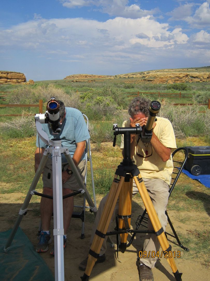

Below my clubmate, Daniel, observes through my PST DS (mounted on a Desert Sky Astro DSV-1 dual saddle alt-az mount atop an Oberwerk wooden tripod) while I take a peek through Daniel's single Etalon, bino-viewer-equipped 60mm Lunt.
Yes indeed. Solar "swingers" swapping scopes without regard to social norms. What do you expect? We're from Northern California.
On a more serious note, this shot is taken at Gallo Campground, Chaco Culture National Historical Park, in San Juan County, New Mexico. The epicenter of North American archaeo-astronomy.
