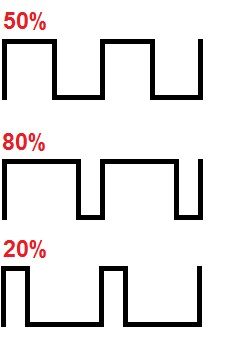

4) Well the system currently uses both your original concept for turning the dew heaters on/off, plus it has variable duty cycle. By reducing the duty cycle you reduce the wattage/heat output of dew straps. This gives you give a lower more even heat, slower change in temp. But it lets me use my C11 dew strap on my 102mm MAK, because I can adjust the wattage way down. This is important with home made dew heater straps, you can control their heat output. Now with the latest changes we are testing you can run each of the different outputs at different duty cycles.
Although we could drive the dew straps in an analog manner, to control the percentage without introducing some feedback circuitry this would be harder to regulate or know exactly what percentage we are driving the straps at. Now using Pulse Width Modulation when a dew strap needs to be turned on, we are turning the straps on/off at about 10HZ. We are then controlling the width of the positive and negative portions of the pulses with fairly accurate control. Wen we run at 100% then stay in all the time they are required. When using PWM and under driving your dew straps, your dew straps will last longer electrically.
