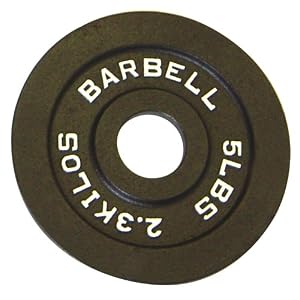

A 5 lb barbell weight can be sandwiched between 2 counter weights or a Orion 7.5 lb cw will work with the CG-5
