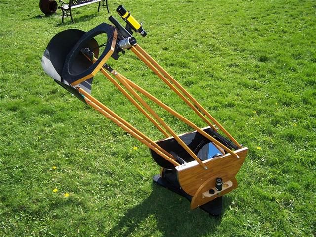

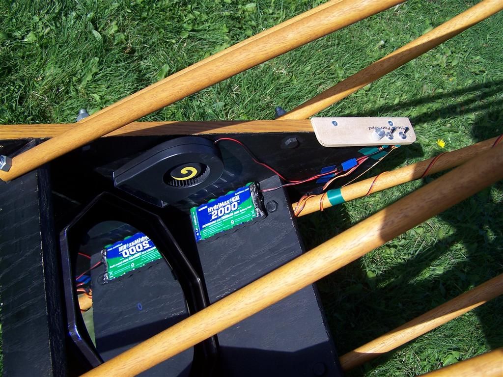

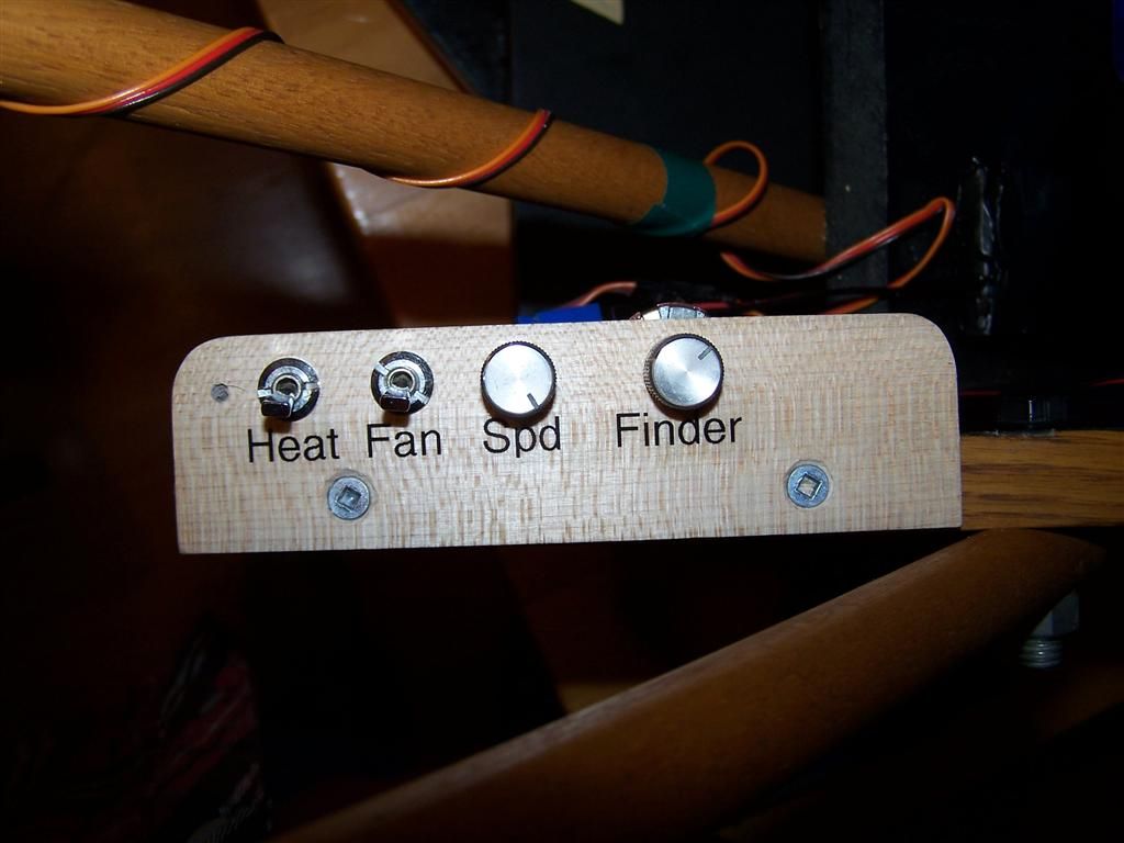

      #5602602 - 01/03/13 09:36 AM
I added a boundary layer fan and speed control, along with secondary dew heating to my 8" truss dob this fall. I've been observing with this instrument for the best part of 10 years.
The difference in performance was immediate and obvious.
My setup is simple. My mirror (8", F6, about 1.25" thick) is passively cooled on the back side, no fan there (yet). Just some mighty holes in the 3 point mirror cell to speed things a touch. I may add a small fan to improve slightly, but right now it's happily loosing 20C in about 1.5 hours.
My fan is for boundary layer control. It's an old computer "ISA slot cooler", a thin squirrelcage style blower. It's fed thru a POT from a 2000mah 8.4V NiMH pack mounted in the mirror cell. The pack also powers the dew heater and the red dot finder, giving about 12 hours endurance for the fan at full speed, or 6 hours with both fan and heat (though I only use the heat in "defog" mode).
I created a plastic louvre on the fan's outlet to distribute the flow across the mirror face. Observing the clearing of condensation from the mirror with the fan running after a session allowed me to tweak the louvre to optimize the airflow as best I could. The pot allows the fan to run down to double-digit RPM's, and I usually run it at about 1/3rd speed during observing. It's velcro mounted to the mirror box, and causes no observable vibration.
The fan installation really helped in seeing fine detail in Jupiter, festoons and detail galore, indeed views I'd thougth impossible with this scope. The Jovian moons have become miniscule worlds unto themselves. Fine galactic detail has improved. Now if only my skies would.... LOL.
