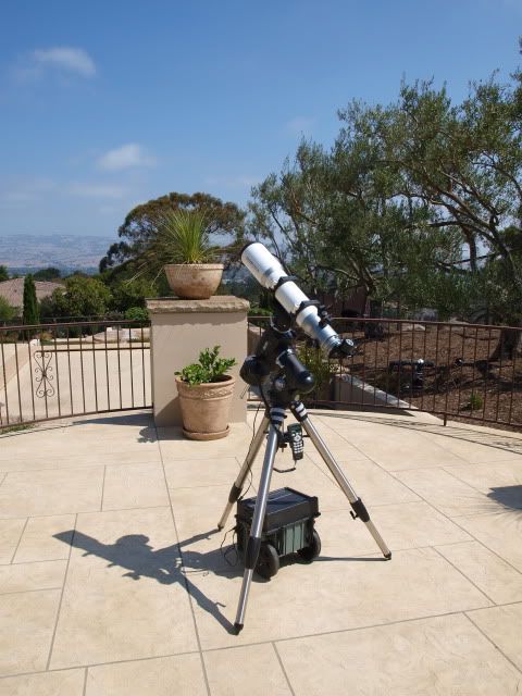

Now take a look see at the lens of my AT111EDT:
http://i95.photobucket.com/albums/l155/jrbarnett_1964/AT111EDT/P8021794.jpg
- Jim
