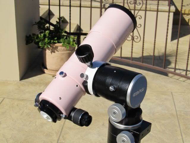

Binojunky
Reged: 12/25/10
Re: Stellarvue SV80S Dew Shade "Droop" problem... new [Re: jrbarnett]
      #5617116 - 01/11/13 11:43 AM
Big fan of Barbie Pink myself, DA.
Re: Stellarvue SV80S Dew Shade "Droop" problem... new [Re: Binojunky]
      #5617166 - 01/11/13 12:15 PM
Yeah, me too.
Though it's more "pale Pepto pink" I'd say.
Binojunky
Reged: 12/25/10
      #5617552 - 01/11/13 04:23 PM
Oh god I,m in love, all it needs is a Mink fur lens cap and its going to be a long loving relationship, now if only it can be trained to fetch a cold beer from the fridge?,DA.
