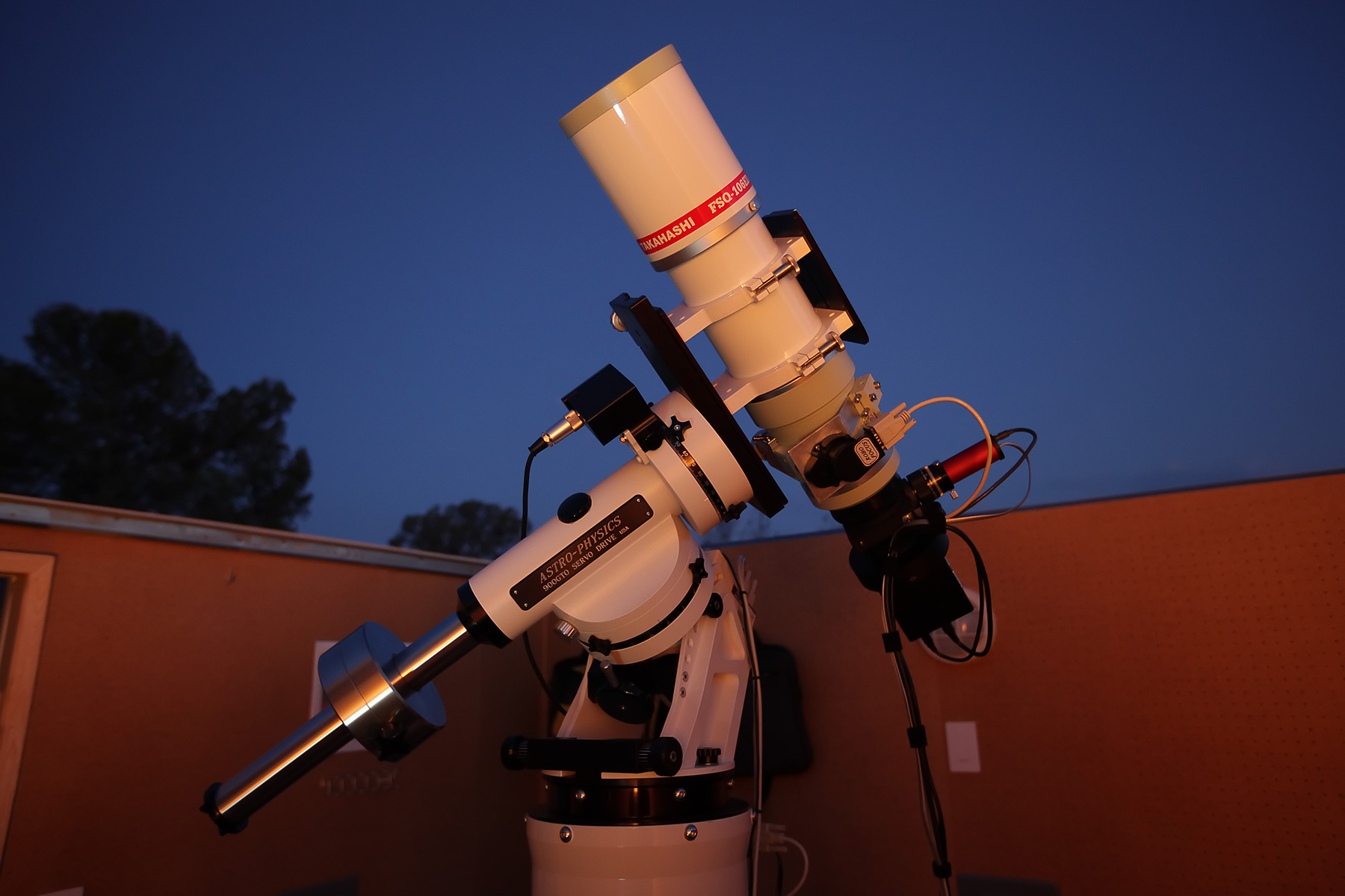

      #5605390 - 01/04/13 07:02 PM
My suggestion would be to get a high-end mount for your scope/s and piggy back 7D. Following are some great design ideas; I would suggest Mach1 if your setup allows. For guiding, you could use standard setup with dedicated scope instead of off-axis; small guider kits... could be an option. Thx
Following courtesy of Hiro:
Link...
Following courtesy of Daniel:
Link...
