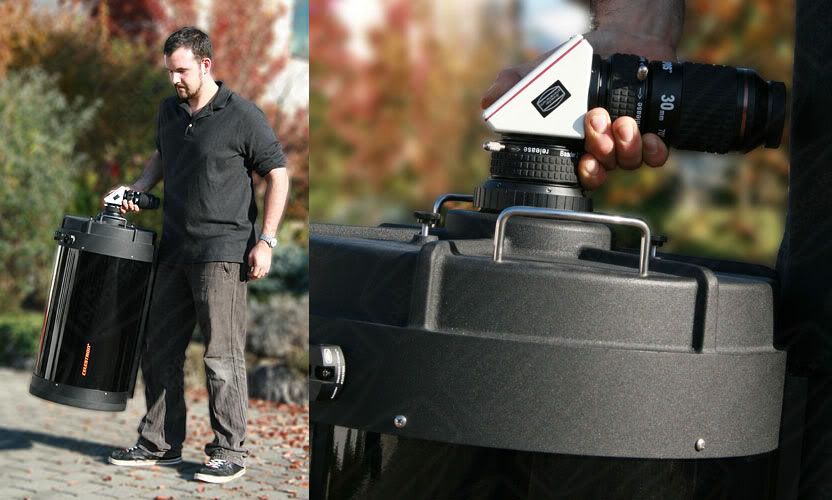

Mark9473
Reged: 07/21/05
Loc: 51N 4E
Re: Compression ring visual back? new [Re: Kon Dealer]
      #5680908 - 02/15/13 09:04 AM Attachment (29 downloads)
http://agenaastro.com/baader-1-25-click-lock-eyepiece-adapter-visual-back-t-2...
Anyone got experience with this?
I think you may need this one.
sct clicklock
The 1.25" version works great as an eyepiece holder on top of a Baader T2 diagonal; the 2" version is what you'd put on your scope to slide the diagonal into and allow easy rotation or exchange with other accessories.
I have one of each (2" clicklock + T2 diagonal + 1.25" clicklock) on each of my scopes and will never give them up.
(note in the image there's a T2 extension ring and a helical focusser between the diagonal and the 1.25" clicklock clamp - it doesn't need to extend this high)
Edited by Mark9473 (02/15/13 09:07 AM)

The Click lock is the most secure and well centered mechanism that I have encountered so far.
Without a doubt. Remember this picture?
If anything was to fail, my bet would be on the T2 threads pulling out of the diagonal.
