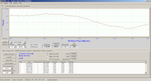

BTW. One cycle of the raw periodic error:
Note the approximately ~3 cycle waveform. That's the massive 8/3.
One cycle with the encoder active:
Notice that the absolute magnitude of the PE hasn't changed (the downward trend is due to polar misalignment) but on short time scales the PE is much smoother with the encoder active. And I don't see any 17-second artifacts (which would occur if there was some interpolation funny business going on).
This convinces me that there's good data coming out of that encoder.. it's just a matter of writing the right software.
And Ulysses, that sounds like an interesting encoder. Absolute, on-board interpolation. But it's only 128K ticks full count (about 10" per tick). And you can't interpolate that further..

      #5768054 - 03/31/13 03:49 AM
Looking at that "corrected" waveform - doesn't it look suspiciously like the fundamental?
On my CGEM the fundamental is 16" p-p, or 0.033 arc-sec / second.
And my 8/3 is 22" p-p (!!!) or 0.12 arc-sec / second.
On the above graph I was using 0.25-second correction intervals. And the 8/3 got knocked out but the fundamental did not.
Over 0.25 second, the fundamental would be 0.008" and the 8/3 would be 0.03" - and looks like the encoder can discriminate the 8/3 but not the fundamental.
On a "good" CGEM the 8/3 is 6" to 7" and it would take a 1-second exposure to produce a 0.03" displacement. So it looks like a 1-second sampling interval should make both a 16" fundamental and 7" 8/3 visible..
The huge downside.. looks like based on the math, if the mount has 8" p-p PE, it would take 2-second sampling intervals to make that visible (and 4 seconds if the PE is 4" p-p). There are definite diminishing returns due to the stone-age analog section and signal conditioning.
Well.. I will try 1-second intervals if the weather permits and see.. but looks like 2" p-p is a pipe dream now..
