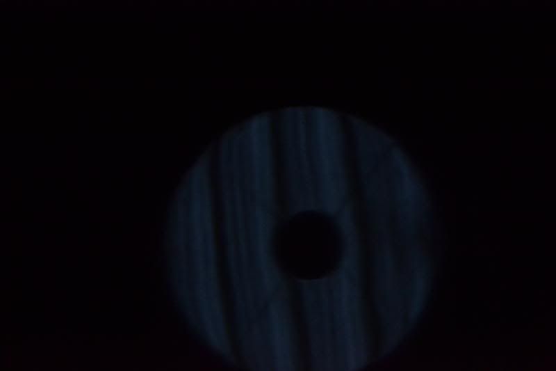

      #5782015 - 04/06/13 02:48 PM
I had trouble taking a picture. I couldnt get my dslr "close" enough and on top of that either tube currents or seeing was making some turbulence. It made the picture turn out with wavy lines but to the eye they were straight EXCEPT the turned down edge
What I could interpret (I think)Is a smooth/turned down edge. Again, lines were straight to the eye except toward the edge

If this pic was taken inside focus, then there is most definitely turned down edge. And to a significant degree.

Can you give us a similar photo slightly outside of focus? Besides the edge, the correction looks a bit off. But this could be a thermal issue so be sure your mirror has had time to cool to the outside air temps.

Yes. And to my eye the lines in the photo above do not look quite as hooked on the bottom as on the top. Maybe an indication of a diagonal edge problem?

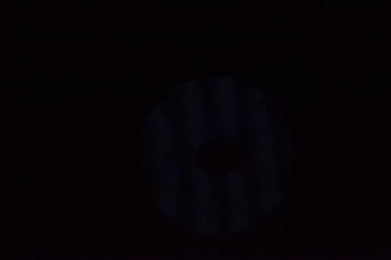

Ok, Ive got a bit of a pickle. In looking through my pics on my camera card I cant remember what was inside or outside of focus
Iam "pretty" sure these first two pictures are OUTSIDE focus
Inside (pretty sure) focus and its not a good quality shot
So if my inside/outside focus is correct I think she is under corrected with maybe a turned down edge

It's pretty hard to see from your photos, but to me things do not look too bad. If the last photo could be a little lighter maybe the edge could be looked at more closely. Also, you need to be sure about the photos to determine if you are slightly over or under corrected. It's not off by a whole lot.

Are these images taken at prime focus using a star as the light source ? If so this an insenitive test and 1/4 wave of error shows up as barely any curvature to the Ronchi lines. So to see the amount of curvature that is in your images, the turned edge and the spherical aberration is pretty large. If the images were taken outside the focus then the mirror is undercorrected by a fair amount. Typical of Coulter 17" mirrors.
An issue with the diagonal would show up as astigmatism and have not effect the showing a turned edge or spherical aberration of the primary. The Ronchi lines would be asymmetrical from the astigmatism which I'm not seeing.

Yes this was pointed at a star. Not prime focuse but eye piece projection. I held the camera up to the EP.
Yes stars focus just fine. I cant seem to eclipse about 180X on planets (mushy image. There is no astigmatism. I always let this primary cool down for a good wile and I run a rear exhaust fan and a foundry layer fan above the primary.

i modified your really dark ronchigram outside focus and it does show one side curve and the the other side straight.

If you are correct with the inside/outside then you have a Turned Up Edge. I would have thought overcorrected with a Turned Down Edge is more likely. Either way, with those images it can't be undercorrected with a Turned Down Edge.
