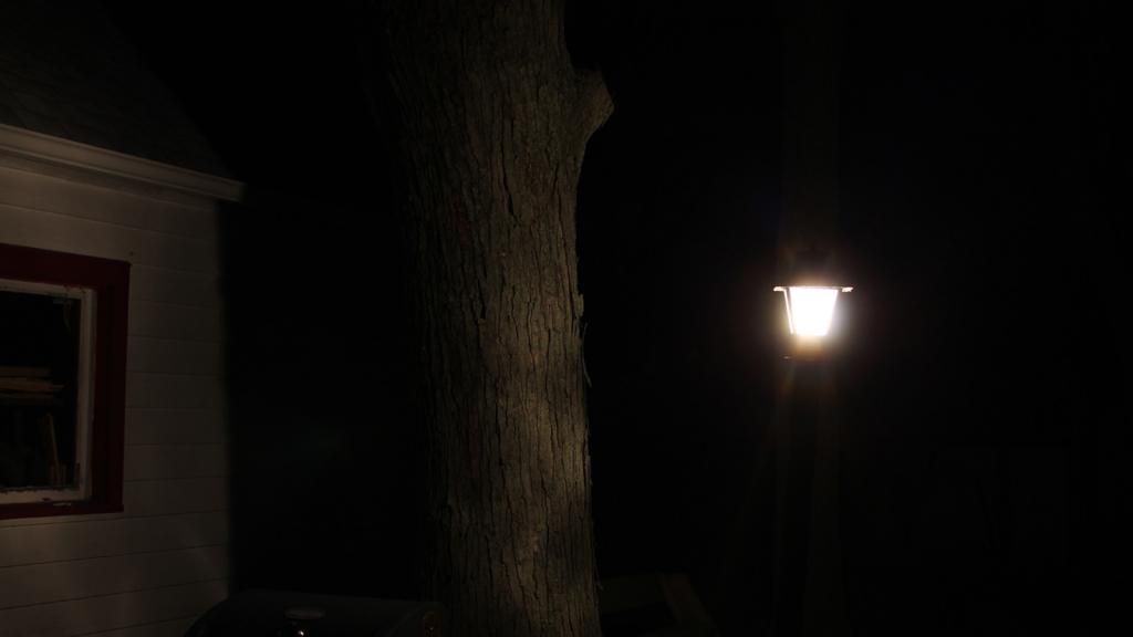

Here is a "before" picture, taken in my backyard, where I have an existing postlamp at the edge of our patio, near our garage:

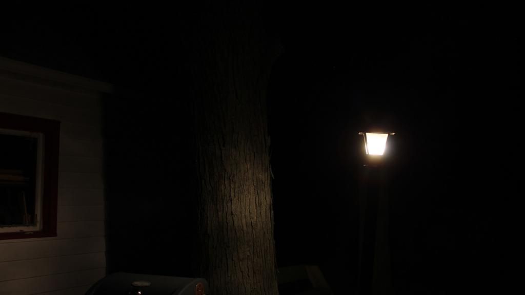

And here is the "after" picture, swapping out the 60W regular bulb to the silver crown top bulb. Note that I controlled for exposure, aperture and ISO, by ensuring they were the same for both pictures.
What the picture does convey well is the difference between uplighting and controlled, downlighting. Note how the gutter on the garage is barely lit in the "after" picture. In the "before" one, it is clearly lit up, and that is more than 8 feet high. The post lamp itself is at about 6 to 6.5 feet.
What the picture does NOT convey well is that in the "before" situation, the whole roof of my garage was completely lit up. Also, after swapping out to the new bulb, the lighting in the entire area was actually better than before, because there was no glare, no uplighting, yet if I needed to see anywhere - faces, people, whatever, it was perfectly lit. These are a fantastic way to control lights on post lamps, no doubt about it.
