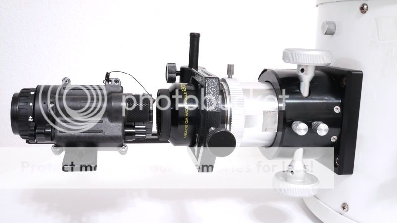

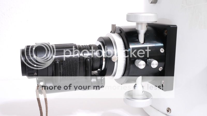

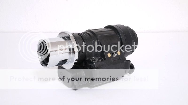

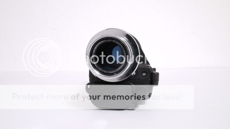

There are two way's I've used a PVS-14 with a telescope, both ways are depicted in the following photos.
Both ways work, the afocal mounting is not ideal but does work. Ideally you'd want to remove any optical train/assembly between the telescope and photo cathode, as the last 6 photos show. I used the objective lens cell housing from a PVS-5A, the lens elements were of course removed.
Afocal...
And...

cnoct, for the non-afocal connection, where did you get the silver part? Did you make it or scavange it from something else? And, how did you attach it to the PVS-5a objective housing? Is it glued or press fit or what?
Thanks.

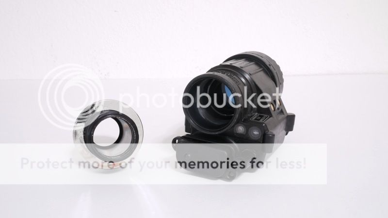

Okay so I got my parts in today and everything mates up very nicely. You don't have to remove anything from or alter the PVS-14 in any way with the parts I used.
You can use these parts to attach it to an eyepiece or you can attach it to a scope without an eyepiece using a nose cone or just t-thread adapters.
See the pictures. I hope this helps others and I can't wait to try it out. I also have ordered parts for attaching a camera to the other end of the PVS-14 and I'll report back how those work out.
Rob
PVS-14 Gen 3 Pinnacle Night Enforcer /w weapon mount for Aimpoint Twist Base
Camera to T-thread Ring for Sony HDR-CX150 Video Camera 30mm (Scopestuff Item#TTSH)
PVS-14 with Camera to T-thread Ring attached
Televue Nagler 31
Televue Nagler 31 with rubber eye cup removed
AdaptaView Eyepiece Adapter (Telescopeadapters.com part# AVIEW
TV Nagler 31 with AdaptaView attached
PVS-14 and Eyepiece ready to be mated
PVS-14 attached to Eyepiece
1.25" nose cone from Atik 460ex
PVS-14 with Camera to T-thread Ring ready to attach to 1.25" nose cone from Atik 460ex
PVS-14 with 1.25" nose cone attached
cnoct
Reged: 09/02/10
Re: How to use a PVS-14 with a telescope? new [Re: robininni]
      #5812280 - 04/21/13 03:25 AM
Thanks.
jdbastro,
The silver 1.25" nose piece was scavenged from a broken Meade 8-24mm eyepiece. The PVS-5 objective lens housing and 1.25" nose piece are permanently bonded with Loctite 638.
Take Care
Rob
Rob,
Your afocal imaging setup is really nice and well thought out, great going.
The 2nd method, wherein the PVS-14 replaces the eyepiece, is really intriguing, didn't know it was possible. Once your able to test this method, do post your findings. In the mean time could you explain how this would be an optically compatible option?
If you get the chance, definitely do some prime focus viewing with an image intensified eyepiece/device, by far the best way to use image intensifiers and telescopes.

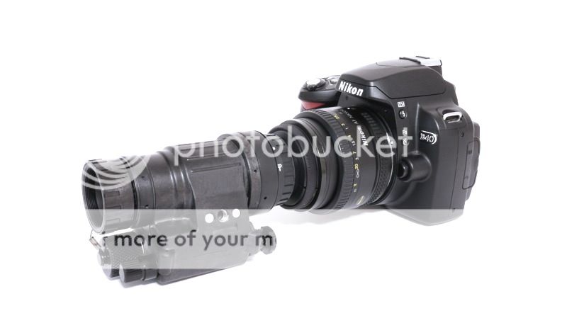

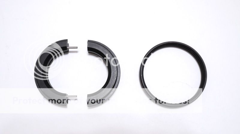

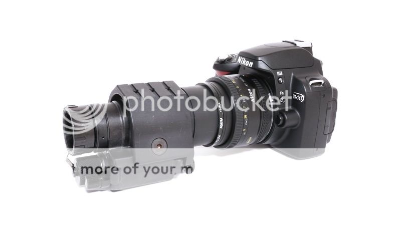

As far as attaching a camera to the PVS-14's ocular, consider the following if you are using a DSLR/SLR: B&H Photo
If you plan on attaching a point and shoot, then there are a lot of options which I'm sure you'll find the best for your camera and taste.
If your going the iPhone route, then consider some of the following options:
Magnifi or US NightVision. There are other iPhone adapters as well, it comes down to preference.
My preference for attaching a DSLR is either the split ring adapter (pictured and linked above) or the extremely rigid housing adapter, both are pictured below. The latter is not made anymore, at least as far as I know, though you might be able to track some NOS ones.
