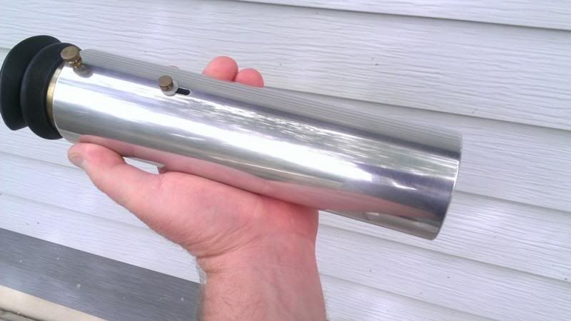

      #5926028 - 06/17/13 05:51 PM Attachment (17 downloads)
So will you come out the same color as the mount
Let's put it this way, I'm already pretty grey!

I've been researching how to preserve the polished aluminum look of some of the components. What I found is that highly polished aluminum will not hold clear coat very well. It will eventually peal. A lot of the motocycle guys and car guys use this stuff, Glisten PC. It is expensive though but is said to last practically forever. It has a self leveling ability as it dries over several days and can even be polished. I bought some to give it a try. You need the hardener and metal treatment product also. It can go on with a brush and still get a very nice finish.
http://www.por15.com/GLISTEN-PC/productinfo/GPCGG/

Tom I've had very good long-term results maintaining a high polish on aluminum by giving it several good coats of paste wax. The trick is to let each coat dry completely before buffing it out, and giving it four to six really good coats.
I polished an old Edmund 8x50mm finder some years ago and it's still shiny. When I get home I'll pull it out and shoot a pic.
Works well on iron and steel as well, but less well on grained texture. You need a high degree of polish for the wax to do it's thing long-term.

I've been told that WD 40 preserves a polish but havent tried it. I use bees wax which seems to work just fine.
Dont use parrafin wax.
I've read quite a bit about polished metals and preserving the finishes. WD 40 works quite well with exposed steel, but must be maintained or the rust comes back. My thoughts are, if I can get the Glisten PC to keep a shine on the counterweights, the $350 cost to chrome them is gone. I love the look of the natural machined surface (grooves) but I am worried about the long term upkeep. If one of you buy this cassegrain off me one day, for $6000 I would hope the finish would hold up. What? ?

Tom, here's the old Edmund aluminium-tube finder that I polished and buffed, then gave 4 or 5 coats of an automotive paste wax with a carnauba base. It's been at least 8 years and it's still shiny. It hasn't been outdoors, just kicking-around in the shop waiting for a scope to be mounted on. But 8 years with no tarnishing is still pretty good.
These originally came with a grey wrinkle finish, then later they switched to a gloss red. This one was an early grey edition.
