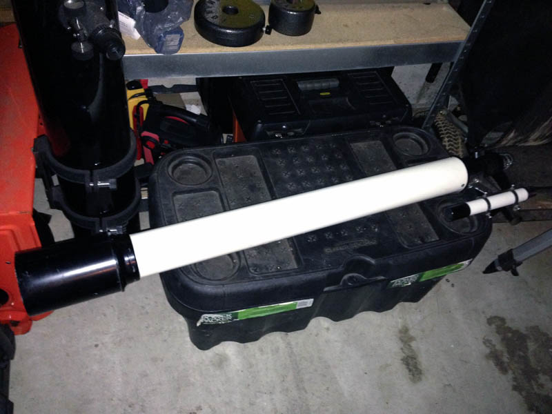

So the other day I salvaged a Sears 4454 80mm F15 scope from being discarded. It is only the OTA with part of of the finder scope (rear element missing), no box, rings, eyepieces or mount. But for free I figured I'd give it a go. The glass looks ok, dirty but I think a good candidate for getting cleaned up. The tube has no dents but scratched up pretty good. The dew shield is dented, but I looked through the threads here and read how to get it back round, (I hope!).
Now I tried to unscrew the dew shield to get to the lens cell but was unable to; the whole unit unscrewed from the tube. I was thinking of possibly putting a few drops of Liquid Wrench on the outside of the dew shield to see if that would help( I already tried using a strap wrench but it didn't budge) but I'm concerned on the liquid contacting the lens. Any thoughts on how to get the lens out?
Also is this scope worth rescuing? Lastly I read where a few users replaced the original focuser unit with a Crawmach focuser; since I don't have any original eyepieces or diagonal would this be a decent mod to bring the scope up to the 21st century?

MikeCatfin
Reged: 03/12/04
Loc: NJ, USA
Re: Sears 4454 worth rescuing? new [Re: teddyk1]
      #5847325 - 05/08/13 08:49 AM
How about some pics
The optics are excellent in these
They were in mine
The scratches on the tube didn't show up well (took the pics with an iPhone) but you can easily see the dented dew shield and dirty lens.
Here are a few pics of the scope:

The dew shield in my pic was not quite as bad as yours but it had a good dent in it. I was able to put it in a small set of sheet metal rollers and roll it back to it's original form without damaging the threads in about 5 minutes. So if you have access to rollers or know someone who works in a fab shop, that maybe a way to fix your shield.
MikeCatfin
Reged: 03/12/04
Loc: NJ, USA
Re: Sears 4454 worth rescuing? new [Re: snork]
      #5849445 - 05/09/13 08:30 AM
Hi Dan, that came out great,but unfortunately I don't have access to a set of rollers.
But having gone through a couple of threads here I did see a post where someone (I forgot who) made a wooden circular jig the diameter of the dew shield and tapped it through to round it out. Since my band saw needs a new motor, I had to come up with something else. I noticed that the 7lb. Losmandy weight fit inside the shield almost perfectly I slid it in through the threaded side then with a rubber mallet tapped the sides until it rounded out. I believe I got it to about 99% round.
