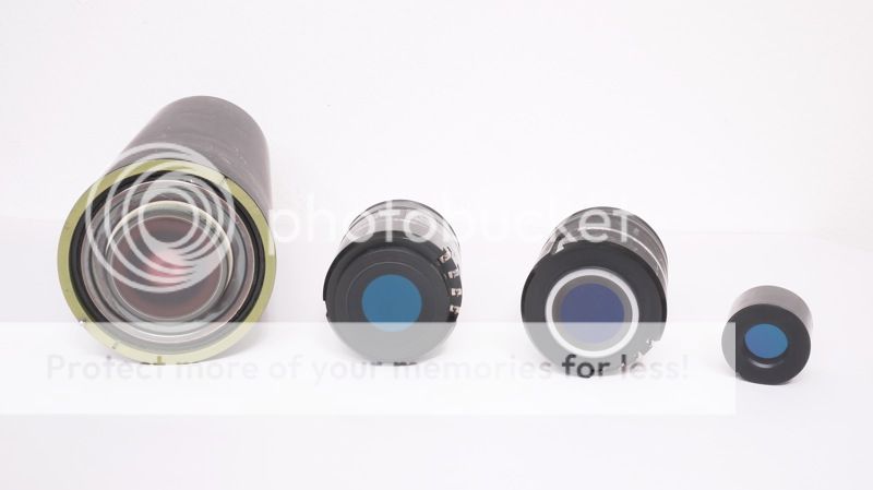

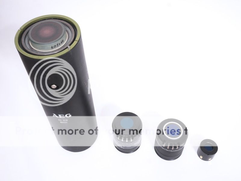

cnoct
Reged: 09/02/10
Re: Perseus Double Cluster Real-Time HD Video thru IIE new [Re: runner70]
      #6048414 - 08/27/13 09:08 AM
runner70,
Your cathode is of the S25 type. The behemoth pictured on the left uses the S25 type as well, though I do hope your tube is a bit smaller, couldn't imagine adapting this one to a telescope.
