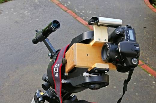

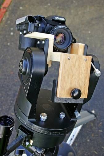

I'm looking into mounting my canon t4i to my etx90ra
As I plan to try to capture images of the Milky Way,orion and so on
I remove my ota all the time and I'm planning on a eq mount in the near future
With the t4i,250mm lens,wireless shutter release
What do you think the 1996 made in china ra drive is capable of?
Do you think it's a waste of time?
Should I just piggy back the camera to my lx200?

You may be approaching (or are on the fringe of) maxing out the payload limits of the drive mechanisms as well as the plastic declination axis that easily snaps. I don't know how heavy those EOS cameras are but I'm sure they aren't anything light like a small finderscope is.

The etx90 ota is heavier than the canon t4i fully dressed

I'm referring to MikeMS posts, not your camera/wood plate creation:
I'm just making you aware that the drive mechanisms are not as stout as you might assume them to be, especially once you attach a SLR camera. I've owned a ETX90 and had it apart to closely examine the drives. Nothing strong enough inside to bank on. Hopefully yours holds up for your application.

The RA mount isn't bulletproof, but it is more ruggedly designed than the ETX-EC mounts. The motor control circuit is simplicity itself and very similar to that of the LX-10. For wide field use it's accurate enough, probably better than your average barndoor tracker. Here's my RA barndoor, if you 'd like any details on its contruction let me know.

Hi George, nice setup! How did you mount the finder so that it is parallel to the RA axis?

The finderscope is off a cheap Meade refractor. I dressed the curved base with a belt sander and mounted it wut the original screws. I just ran a tap into the base's plastic.

Hi George,
I'm still wondering how you got the finder aligned with the polar axis. Can you give us some more info?
