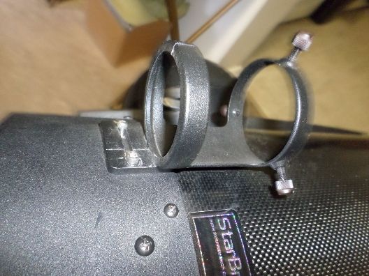

purchased this new Explore Scientific straight through finder for my Nexstar 11 GPS. I was not sure if it would fit onto the scope and lo and behold, it doesn't. Obviously I need an adapter or different base so I can use the two ring six screw rings and dove tail that came with the finder. I could put the finder into the existing rings which are shown in the picture, but I don't like the three screws on only one ring. What do I need to make this work?

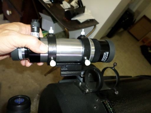

More pictures:

You will need a new base. Possibly a new set of rings and base depending on the x-section design of the foot of the base to the rings that you have. The rings that you have on your finder probably have a proprietary design for the base that fits to the foot of the rings.
There are a variety of suppliers of these: Losmandy, StellarVue, etc.

I recently got the non-illuminated version of that finder for use in a standard GSO/Synta shoe, it came with no base. I went to the the ES website, chatted with support online, and they are mailing me the necessary adapter. Pretty good service, I'd say.

No it does not come with a base. It has a dove tail only which is shown in one of my picks. I can use it with the existing rings that are on the scope already but I hate that set up with three screws on one ring only. I really want to use it with the two rings that it came with already with six screws.

Good news: that finder brcket has been used for years by Meade for SCTs. Bad news there are at least 3 variations of the shoe. Some work if a little metal is removed others are way off. If you get me a fairly precise measured drawing of the shoe I may be able to match it.

If you can mount the front of the finder with an O-ring and if the three rear screws provide sufficient adjustment for alignment, why bother with 6 screws?

why don't you simply get a Stelarview set like I have that works with the finder.

I'm with you on the 6 screws question. The only reason I see for 6 screws instead of a o-ring and 3 screws is that 6 screws allow for a wider range of adjustments for times where base isn't mounted very parallel to your scope. Orion's finder uses only 2 screws, with the 3rd point being a spring loaded pin. It's even easier to use. (I have a 6 screw SV finder and while using it is a joy, aligning it is not. )
