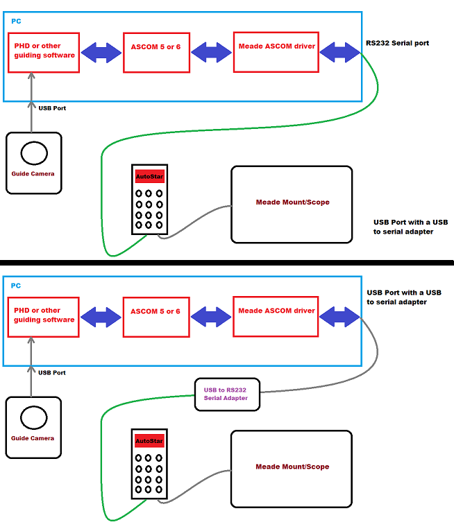

This is what Uncle Rod is talking about:
I believe you would use the Meade LX200 Classic ASCOM driver. Then you have to select this driver in ASCOM. Be sure and set you serial port or adapter like this:
Baud Rate - 9600
Data Bits - 8
Parity - None
Stop Bit - 1
Flow Control - None
This is how I guide my Meade LXD55 mount.

My setup is exactly like the bottom image, just wondered if I'v downloaded all programs needed, this is a summery :-
PHD Guiding (windows) v1.14
ASCOM Platform 6SP3
Meade LX200 Classic and Autostar #494, #495, and #497 driver (combined telescope/focuser, 5.0.4)
Meade Autostar Suite V5.50
Have also checked there all working on same com port (comport4)
Just said about Autostar Suit to explain that I'm getting a connection via USB/RS232 adapter otherwise wouldn't be able to use autostar remote goto? so why is it not connecting to PHD via ASCOM ???
Dave.

Be sure you are connecting PHD through the ASCOM driver and not the non-existent ST-4 port. Also make sure you have got your serial cable, USB-serial adapter, and com port number ducks in a row.

You don't need or use Autostar suite for guiding. The rest of it looks to be OK.
What kind of USB to Serial converter do you have? Most of the cheap ones don't work!
Try running the Autostar updater, press the "Connect" button and see if it can connect to your hand controller. This will eliminate the ASCOM software and Meade ASCOM driver. If it works, your problem is probably in the PHD or ASCOM configuration. If it doesn't work, then it's with the USB/Serial converter or cabling.
