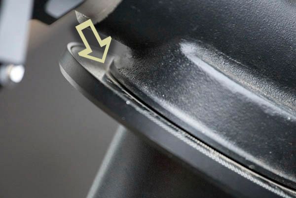

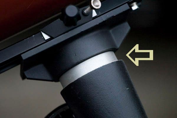

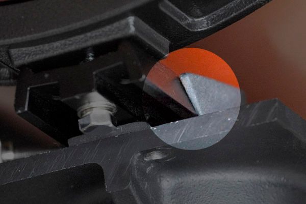

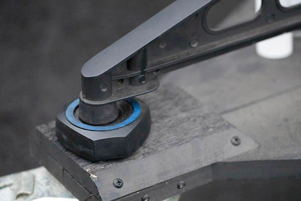

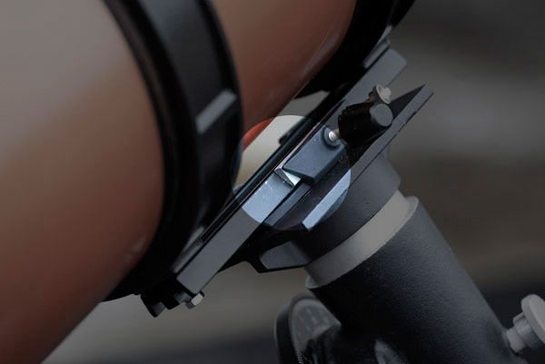

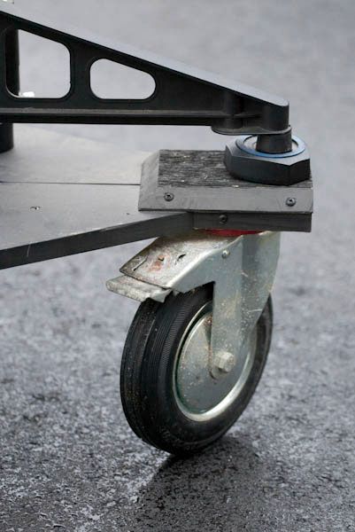

      #6320653 - 01/18/14 02:31 PM
Okay, so I've definitely narrowed down to two huge culprits, and they're both my own dumb fault. The first is that the casters, despite being locked when in use, still have a lot of play. After pulling the whole unit off of the dolly much of the low frequency vibration reduced. The second issue is my homemade dovetail saddle, which I already suspected as a partial issue. It seems to allow some loose vibrations at that particular part of the joint. I do think that perhaps the moment arm of the BV on the 45" tube might still be a tad much for the mount, as it seems there is some slight flexure at the top of the pier. However, at this point, I'll have to :
1) Redesign the dolly to at least include leveling feet to bring the casters off of the ground
2) Just buy a dovetail saddle that actually hold the OTA without flexing
3) Tightening everything down as has been suggested by several of you
Once I have done these three things I'll reevaluate.
At any rate, here are some images:
The rig
Industrial casters
Vibration suppression pads
My weak saddle, which is the aluminum top chopped from a Celestron 70-AZ tripod
Am I missing something here?
Is this spacing close enough
And here's a big one...how do I upgrade this!?! It really doesn't hold the tube from moving on the Dec (I think) Axis...
