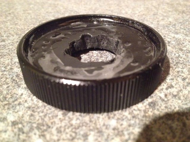

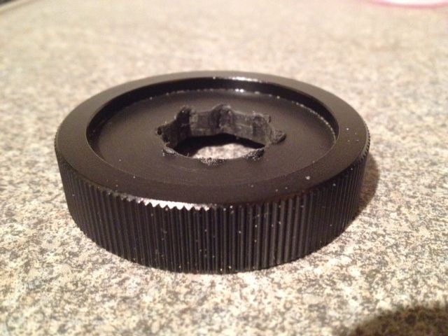

      #6328441 - 01/22/14 01:45 PM
Made one from a camera adapter and plastic discs. Works well and nice press fit.
May end up buying a feathertouch but this is ok for now
