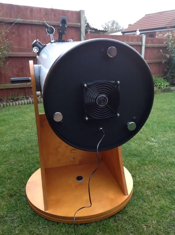

      #6490853 - 04/26/14 09:50 PM
I don't get any vibration.
Noise blocker with its own rubber suspension for vibration free blowing.

Really nice job on that Nevy.
