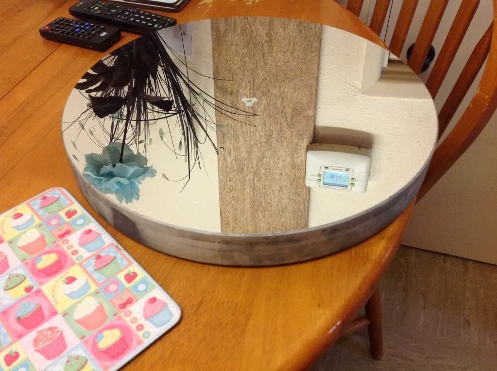

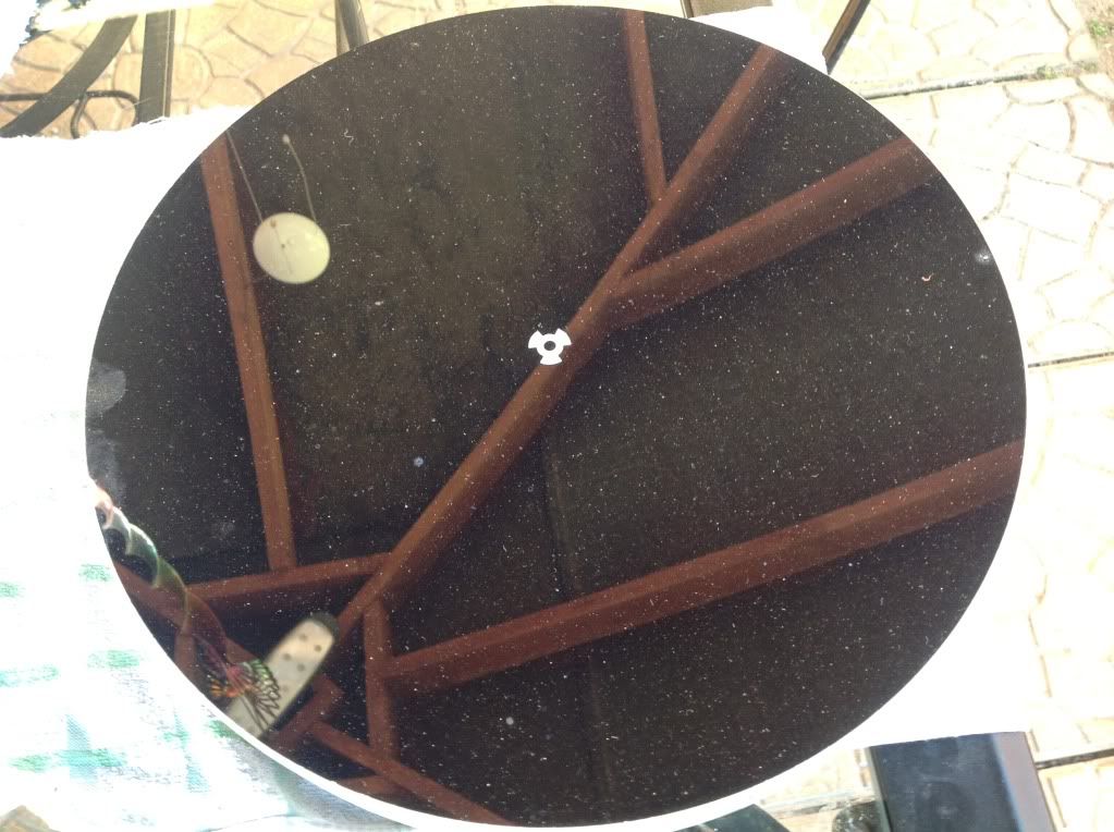

#66 nevy
nevy
  • Posts: 1,470
  • Joined: 07 Feb 2012
Posted 12 October 2013 - 10:26 AM
I just use washing up liquid , doesn't really matter what brand , I just use whatever the missus buy, this is before the clean
[image]http://Posted Image[/image]
And this is after

#70 nevy
nevy
  • Posts: 1,470
Posted 14 October 2013 - 01:28 PM
The coating is the original & I've had the scope for about 6 years , I wash the mirror at least twice a year & more if it needs it so washing up liquid should be safe enough , you only need a couple of drops in a litre of water.
