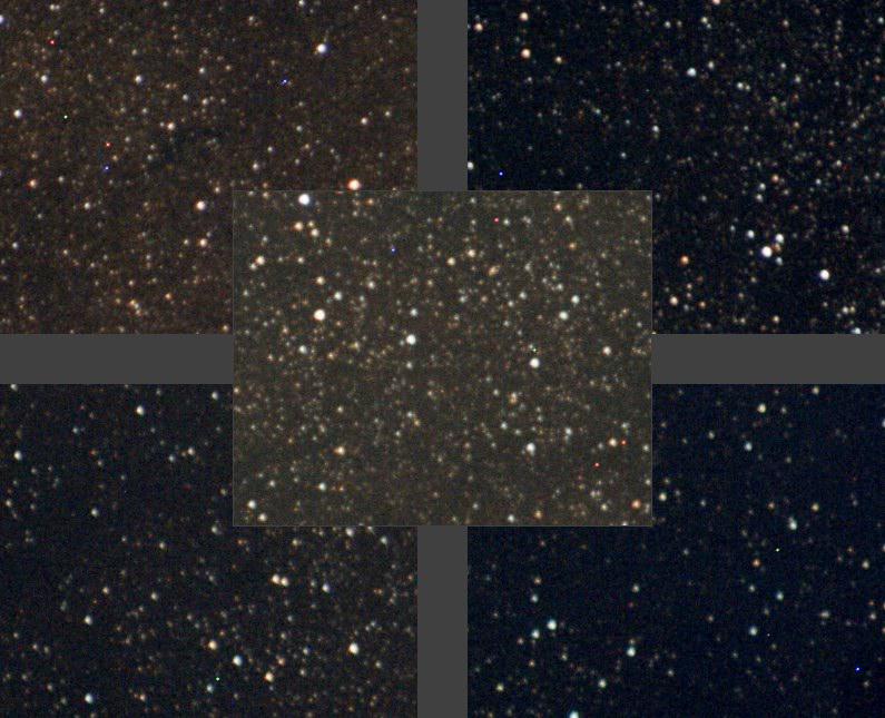

1:1 Resolution Corners and Center crops at f/4.5 (Wide Open)
