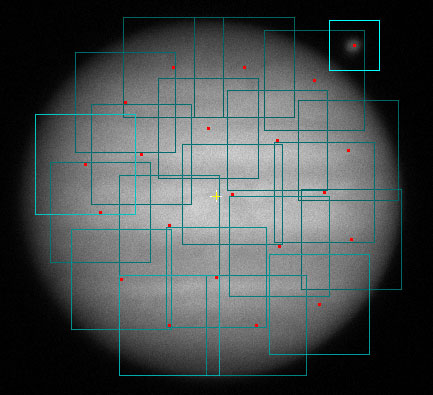

Some ideas to place alignment points.
Notice the extra small AP placed around Ganymede at the top. Small round features such as a moon or shadow of a moon often track really well, so place an AP around it (this can also work for the GRS or other very stable features)

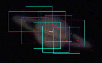

Saturn can be a bit more difficult to process. DON'T use automatic AP placement, but place the APs manually instead. An AP is only strong if it can track features in two perpendicular directions (AS!2 favours x-y directions, but it can also be diagonal or anything in between).
Most important lesson: experiment with different APs!
