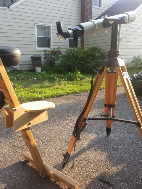

I use my homemade wedge without the nd3 filter and no polarizer on the moon. the colors really pop.
