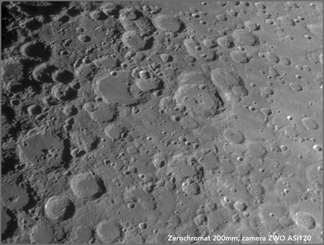

If you just take a picture through the eyepiece then you get just the resoltion that is selected by the camera. For a high resolution photo you need a good camera and and take the videos in the focus. Here is a photo I took with the ASI 120MC and my Vixen 80L:
http://www.astrobin.com/full/126009/0
There go to full resolution. That comes close what it vivisible with the 80 mm refractor. OK the colours are nicer in the eyepiece but you see the problem. If I had taken a photo with 1024x768 I cannot get  the resolution of the telescope. :)

Hi Roland
That is an amazingly good image for an 80mm. It's so incredibly close to the eyepiece view.

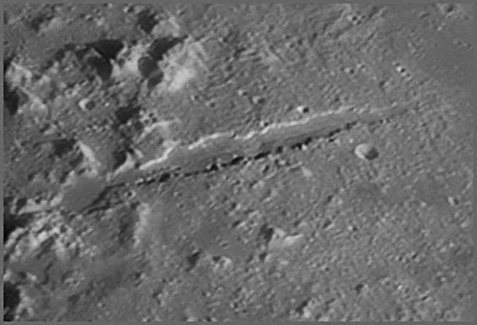

Posted 17 March 2016 - 06:30 AM

Last night was seeing 7/10 and I made a few photos of the Moon.
Now THAT'S what I'm talking about! Much better. Excellent images!

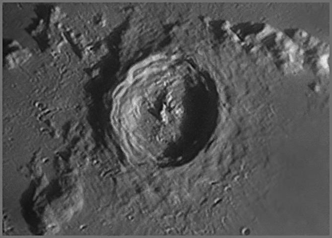

Today, crater Eratosthenes, Zerochromat, B/W camera  DMK21 and 2x Barlow.

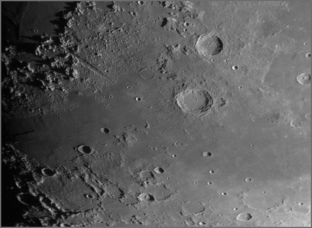

Vallis Alpes is not so good, seeing was worst. Zerochromat, B/W camera  DMK21 and 2x Barlow

Congratulation!!!
Good enough seeing to resolve the Alpine Valley rille!  Really liking the pictures you're getting with this scope.  Thanks for sharing.
